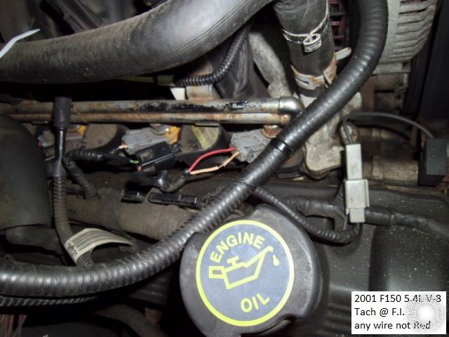

For the 4105 Tach connection, you would run the Violet/White wire through the firewall out to the
engine and connect the wire to any convenient F.I. There are two wires at the F.I. One of them
will be Red. The other wire color is different at each F.I. That is the wire to connect the 4105
Violet/White Tach Input wire to. Below is a Photo of a typical Ford V-8. Your Mustang will be
similar.

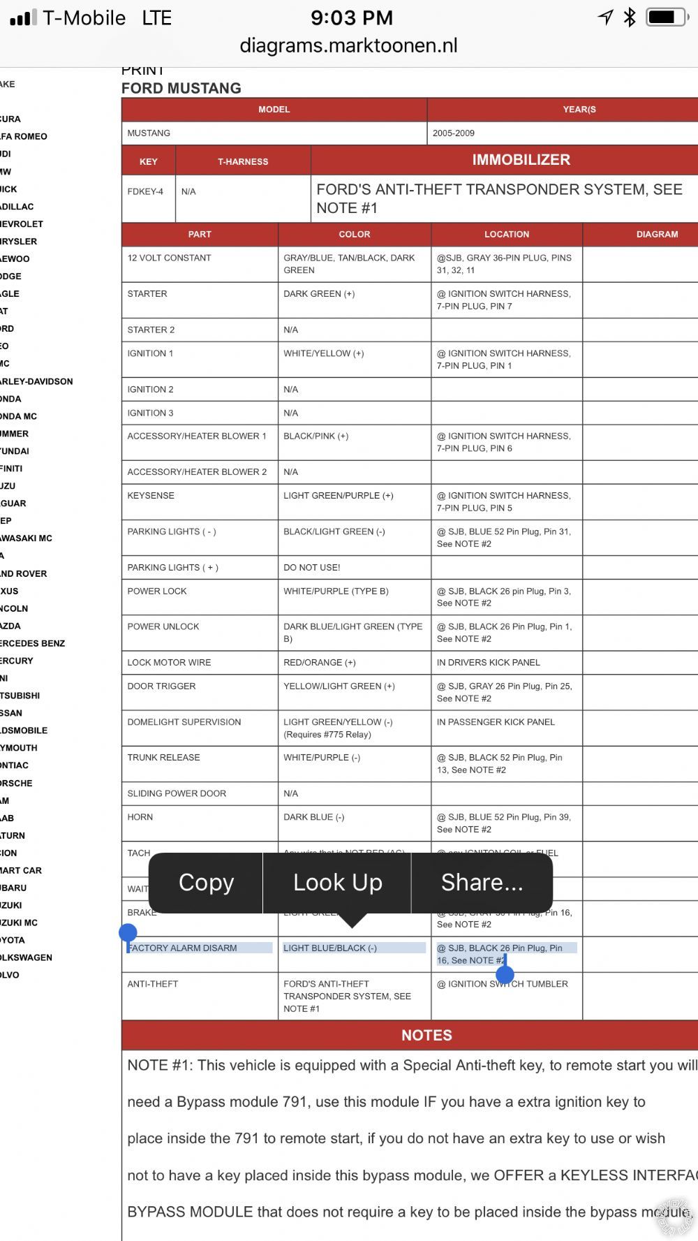

Green/white to LT BLUE/BLACK (-) BLACK 26 PIN PLUG, PIN 9ad
There is only lt blue/black and it is pin 16 Avital 4105L, Expresskit Pkall, 08 Mustang -- posted image.
Is there something wrong ..??

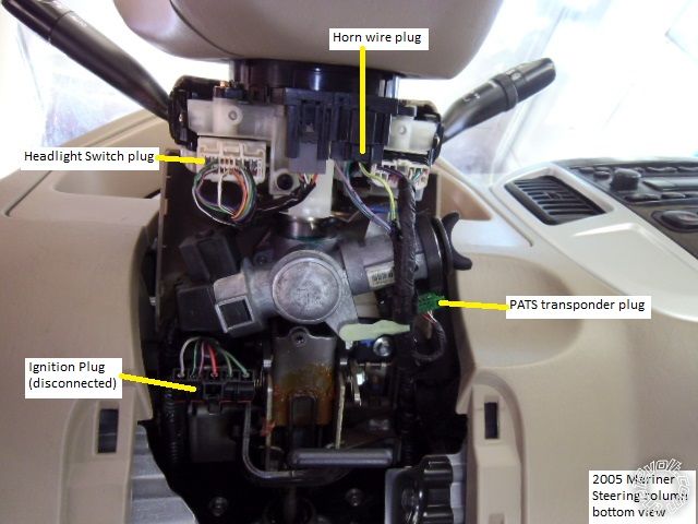

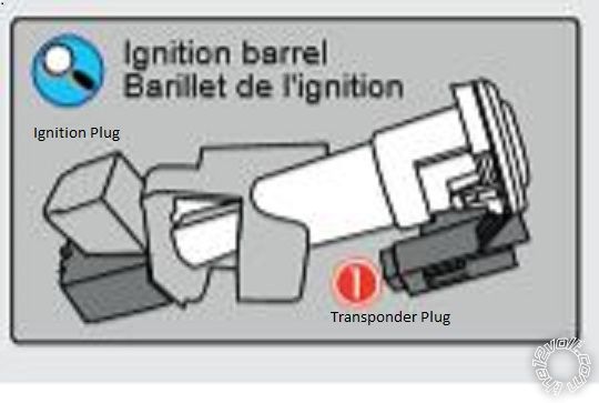

Pls help I can’t find the ignition switch harness 7 pin .. location!!!
Someone pls help !!!
David
Platinum - Posts: 7,828
Posted: February 19, 2018 at 6:14 PM / IP Logged
Did you remove the steering column covers? Looks something like this :
