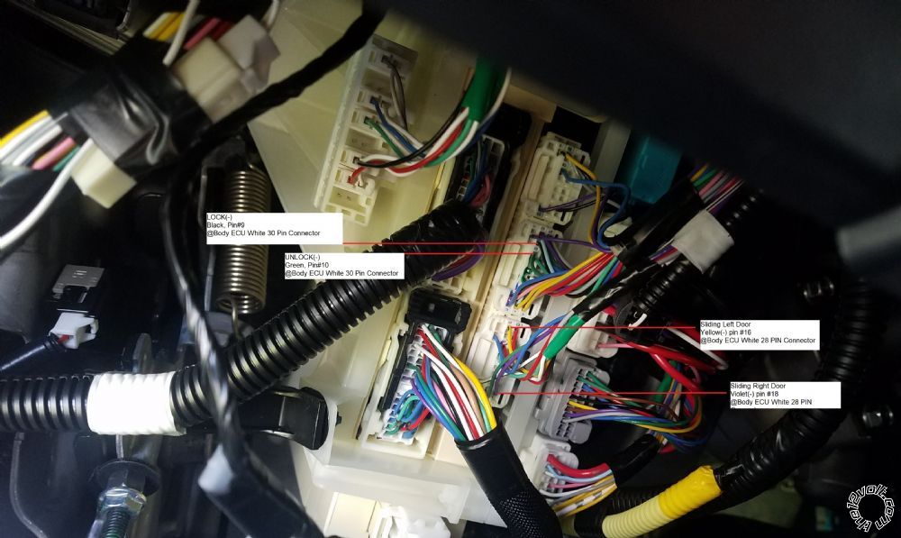

The only thing I can't figure out is the Parking Lamp. You said:
Parking Lamp (+) GREEN (+) @ DRIVER DASH FUSE BOX
But, for the life of me, I cannot figure out where that is. I don't see a distinct green wire going into the driver's fuse box. I took a few pics of the area:
https://imgur.com/a/vyXtGVw
(I also included some snapshots of the EWD for the "Turn Signal and Hazard Warning Light" from TIS for the 2018. Dunno if that helps.)

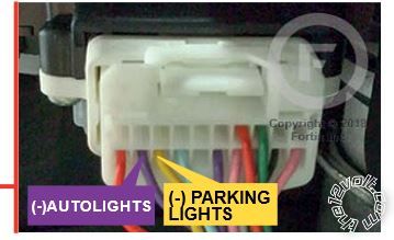

Most installers use the (-) Parking Light wire. The (-) Parking Light wire is very easy to find at the Headlight switch
connector. Your PKE unit only supplies (+) Parking Light outputs but you can get around that if you want. All that is
needed is a SPDT relay to convert the (+) Parking Light output to a (-) signal. Here is the info :
PARKING LIGHTS ( - )    YELLOW (-)    @ Headlight connector, Pin 18 of 20.
Photo of headlight switch plug.
2018 Toyota Sienna LE Keypad Install -- posted image.
You can test for this wire by using a Digital Multi Meter set to 20V DC. Connect the Red lead to +12V constant
and connect the Black lead to the suspect Yellow wire. With the switch in the OFF position you will read 0V. With
the switch set to Parking Lights you will read +12V. Here is the relay wiring :
Relay Pin 86 to either Yellow (+) Parking Light output wire from PKE unit
Relay Pin 85 to Chassis Ground
Relay Pin 87 to Chassis Ground through 2 amp fuse
Relay Pin 30 to Yellow (-) Parking Light wire at Sienna Headlight switch connector
Relay Pin 87a - not used - insulate

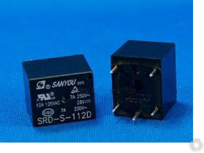

I use mini-relays rated at 10 amps for this type circuit. They can be found on EBay for around $1 but require
some soldering to add the needed wires.
If you want a mini relay that comes pre-wired, look for a Directed
8616. You can also use the larger 30/40 Amp relays.

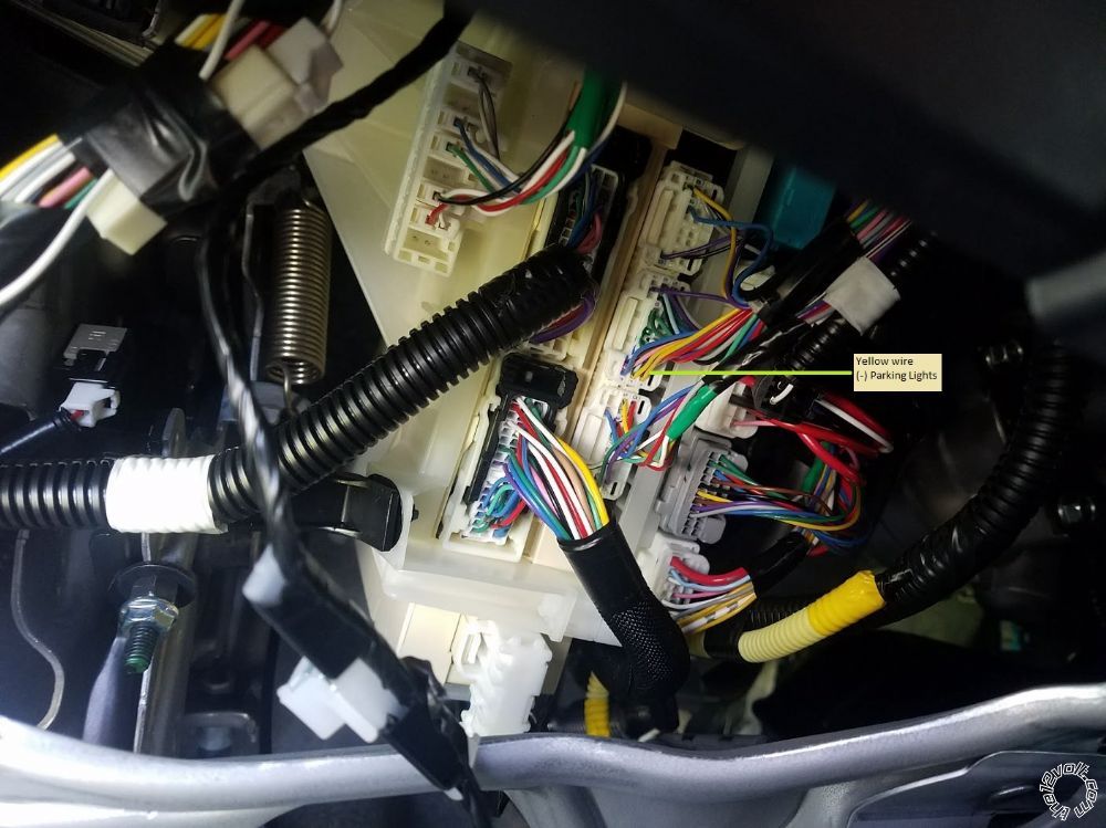

I'd also be willing to bet that you could get the (-) Parking Lights at the Body ECU.
It should be the Yellow wire indicated in your revised photo below :

Cool. Thanks!
Also, if anyone else is looking at this. Here are the other connections that worked for me
