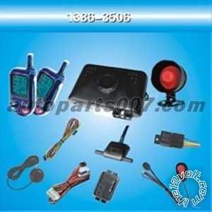

Inwells 1386-3506 Alarm, How to Reset? -- posted image. Anyone ever have one of these and know how to reset the control box? It acts like there is a security issue after remote starting it runs for 30 seconds or so then shuts down during this relays are clicking in it I assume its for the parking lights (which aren't hooked up yet) I wanted to make sure it was operable before hooking up all the other features. The install is in a 2005 Colorado tried using a DB3 wouldn't bypass the passlock 2 system soft reset and relearned it numerous times with no change so I bypassed with a resistor and relays per DEI tech doc 1603 now it starts and shuts down? Any Ideas before I take a B.F.H. to it!Inwells 1386-3506 Alarm, How to Reset? -- posted image.

How have you connected the door open sense input?

Yes I hooked up the door input tried with and without it made no difference. The key fob indicates lights on but I'm not hooked into the lights yet but the vehicle has DRL so that could be the issue with the light warning I'll pull the relay on it see if it goes away.
