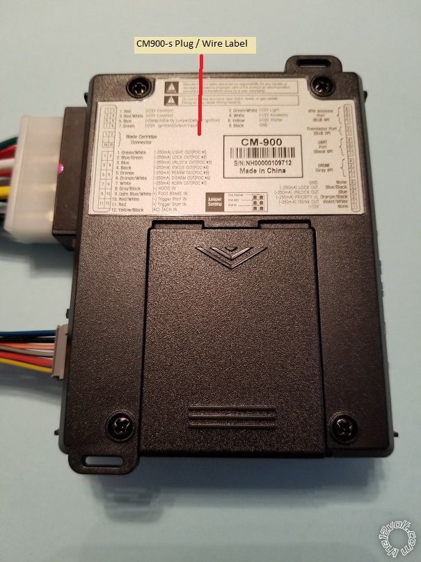

There should be a small ( 4.5" by 6" ) install guide booklet in the box. The wires are also identified
by a label on the back of the CM-900 brain. I just uploaded the guideto the Downloads Section :

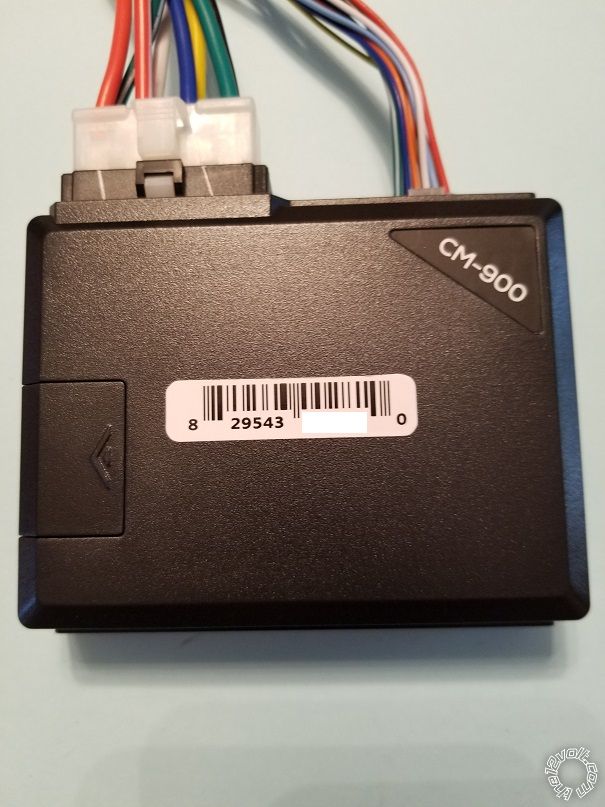

And a CM900-s brain that looks like this :
Compustar CS4900-S Remote Starter -- posted image.
The wires are never marked or tagged, just color coded and at specific Pin locations on a
specific harness. Compustar uses that brain, CM900-s, in a number of different models,
each with a different number. From one button to 4 button short range to 4 button long
range to 2-way remotes, etc.
