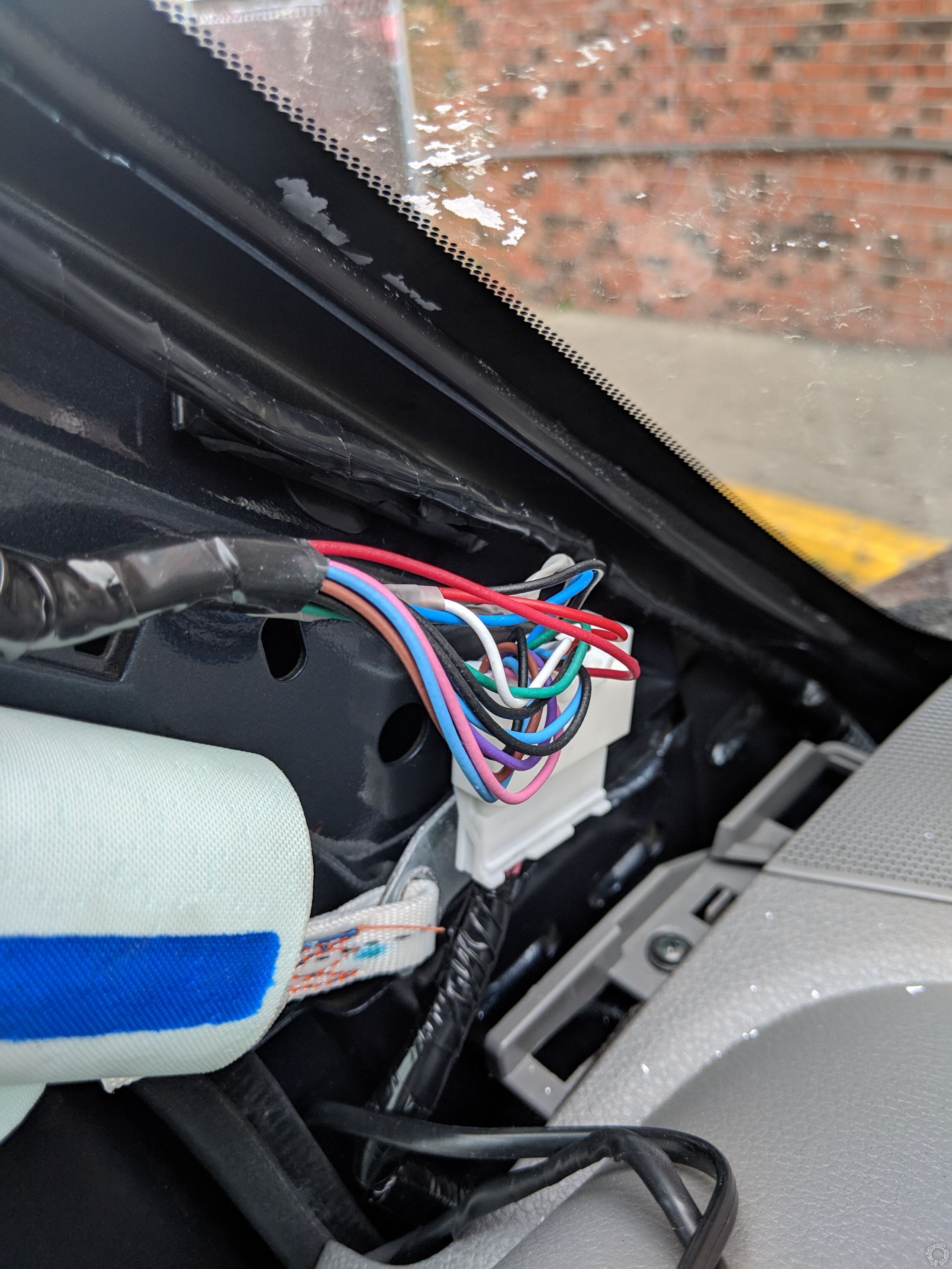

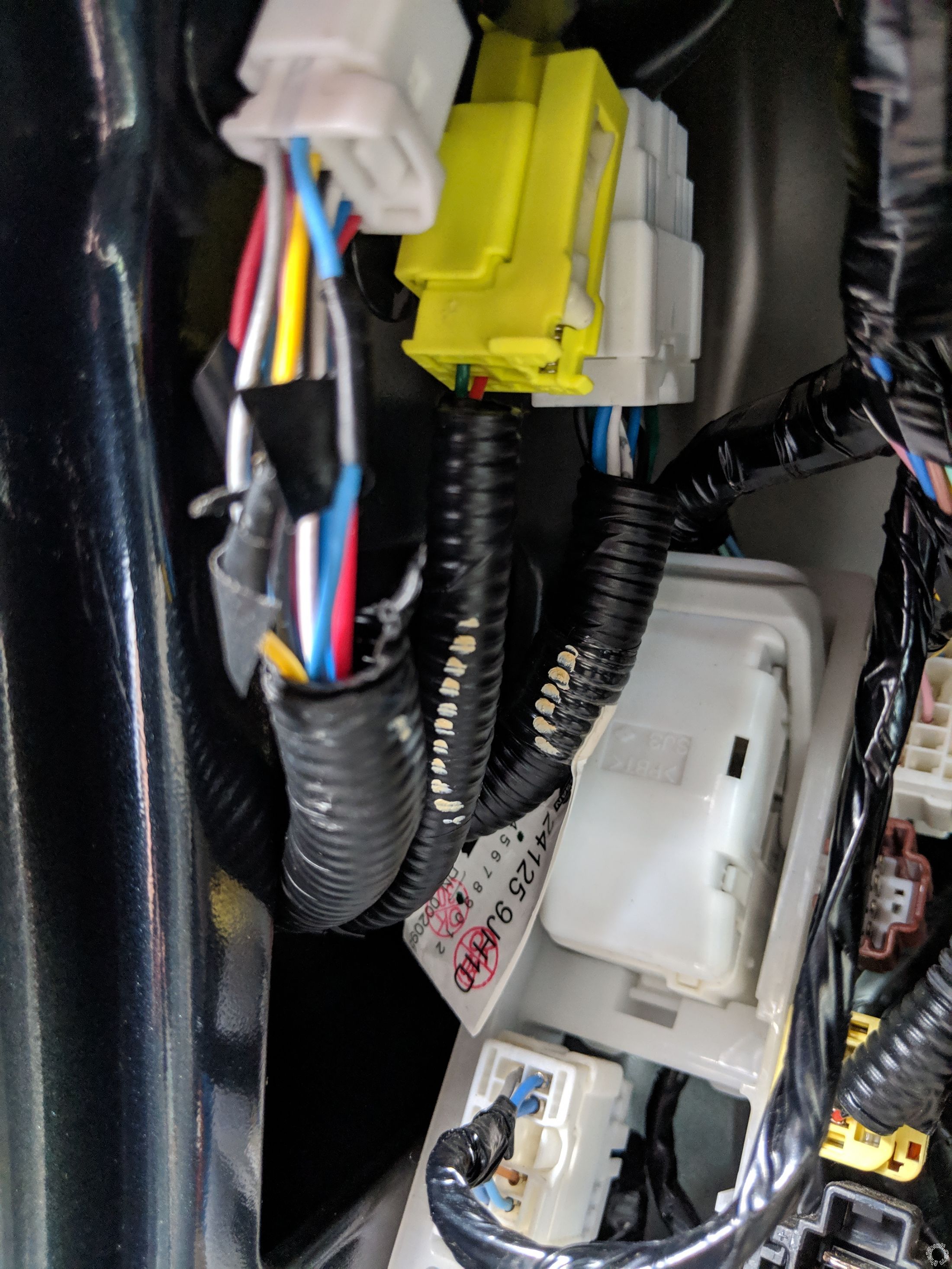

Sorry for the delayed update. I attached the acc wire, and have been successfully using it for a few days. The heat and a/c work, but the radio does not turn on until I turn the key. I assume that is by design.
I attached what I believe is the wire for the horn, but I cannot get the remote to make any horn beeps when I lock the vehicle. I am also having difficulty locating the wire for the lights   I used wirecolor.com for the wire locations. It states that the wire should be in drivers A-pillar. But the wire colors in the photos do not match up with what I have.

For the Parking Lights, try using this wire :
Parking Lights       (+) Red       Driver Kick Panel, White 4 Pin connector, Pin 3
Make sure the 4105 Parking Light jumper is set to (+).

Regarding the horn, I followed the programming steps (I know everything is connected correctly, because the horn beeps during programming). I think I have it programmed correctly now. When is the horn supposed to honk (locking, I suppose). Any other time? I noticed that if I long press lock, the alarm goes off.
Regarding parking lights, I cannot find such a connector. I have attached pictures both of my kick panel and of my A-pillar.
