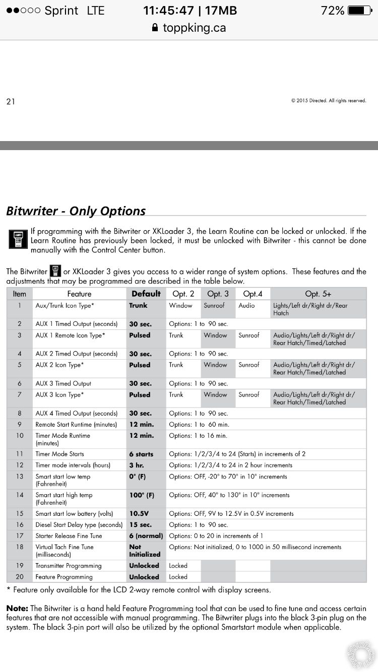

I looked around at some Viper manuals and observed that with a bit writer the hot start can be set from 40 to 130 in 10 degree increments. So maybe setting the hot start on one of those units to 70 degrees may work for your situation. Not sure the smart start limits for number of times but it seemed maybe like the setting was tied into timer start and could be set up to a max of 24. I have never installed one of those but perhaps Viper installers may be able to shed more light on whether it could be tailored to your needs.
4706v Install manual
Custom Remote Start - Thermostat? -- posted image.

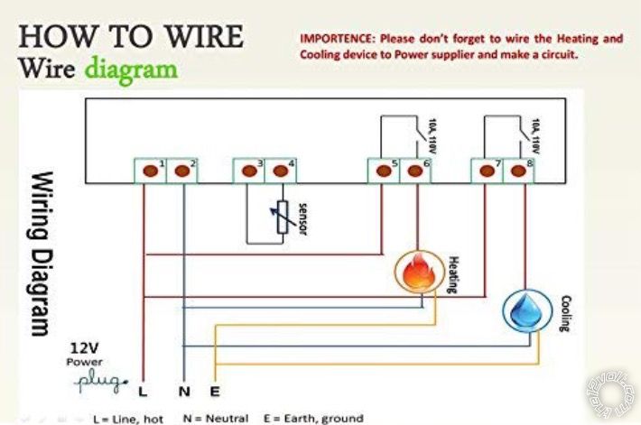

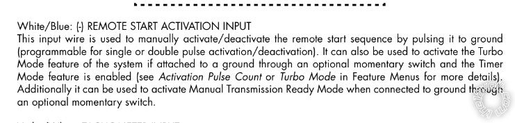

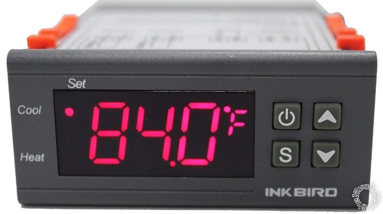

I was also looking at Amazon at some inexpensive temperature controllers that run on 12 volts. At the set temp it could be used to trigger the activation input that most remote starters have as an option. The input is typically tied to the output of some other alarm system or tied to door locks to trigger a remote start from pressing lock a few times on the OEM keyfob. This input could trigger anytime the temp controller sent it a turn on command.
Here is an example of an inexpensive one but I'm not sure the reliability of these. Amazon 12v temp controller

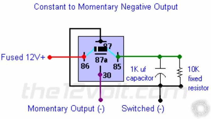

Seems that when the temp is achieved it will turn the cooling relay on and leave it on until the temp falls back down. The remote start input usually can be set to one pulse. I'm not sure if it would cause a problem if the controller was putting out a constant output on the wire that only needs a momentary pulse. You could try it and it may not be an issue. But if it was this relay circuit could be added between the controller and the activation input to change it from a constant to a momentary output.
Constant to Momentary output
Using this setup would make it more automatic rather than the smart start setup which would require a sequence of button presses to set it after everytime the vehicle was driven.

I don't think it would work like that. If you set hot start to 70 it would start probably at 70 degrees but it wouldn't shut anything down at 70. It would just start when it hit 70 and run for the amount of time that it was set for in the smart start settings. It's 12 minutes by default but adjustable from 1 to 16 minutes at option 10 in the
"bit writer only settings"
Smart start mode would also need to be enabled manually everytime you were done driving. I didn't see any option to keep it enabled automatically.
