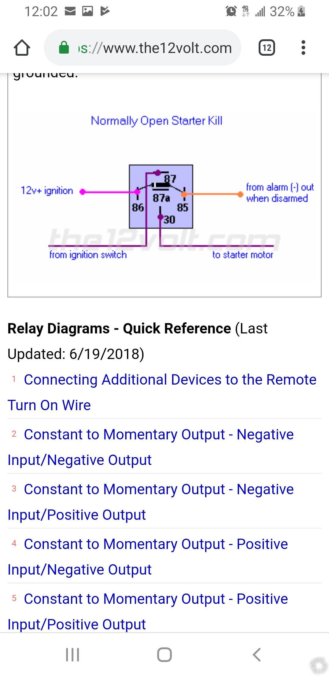

Starter Kill Relay, 1968 Chevrolet Chevelle -- posted image.

Posted: June 22, 2019 at 12:14 PM / IP Logged Link to Post Post Reply Quote 1978malibu
86 to key ing
85 to alarm output
87 to ing switch
30 to starter motor
Is this correct?

Posted: June 22, 2019 at 12:23 PM / IP Logged Link to Post Post Reply Quote catback
1978malibu wrote:
86 to key ing
85 to alarm output
87 to ing switch
30 to starter motor
Is this correct?
Yes 86 to ignition switch HOT in RUN and CRANK wire
85 to alarm ground while disarmed*
87 to ignition switch START wire - ignition side of cut
30 to ignition switch START wire - starter motor side of cut
* the alarm MUST output a constant ground on this wire while the system is disarmed. A pulsed factory disarm or door lock unlock signal WILL NOT work.
Platinum - Posts: 13,722
Posted: June 22, 2019 at 8:20 PM / IP Logged Link to Post Post Reply Quote i am an idiot
What alarm has a ground when disarmed?
Malibu, what kind of alarm do you have?
