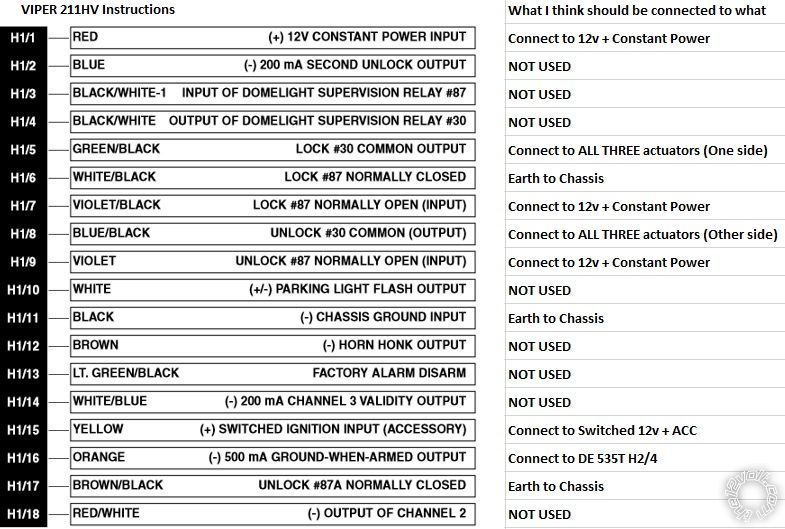

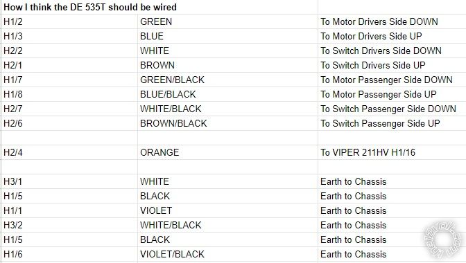

Ok, after a lot of searching I think i have an idea of how to wire these up.
The car has never had power windows or central locking so i have purchased the parts at the bottom of this post.
Please can someone just confirm that my wiring makes sense (and is correct)?
1979 Volkswagen Bus, Keyless Entry, Power Windows -- posted image.
1 x Directed DEI 535T (Windows Automation System)
2 x BMW 2 wire window motors (Drivers and passenger doors)
3 x 5 contact window switches two for drivers side (operate driver and passenger window) + one for passengers side (operate passenger window)
1 x Viper 211HV (1-way keyless entry system)
1 x 5 wire MES Swiss Door Actuator (Drivers side)
2 x 2 wire MES Swiss Door Actuators (Passenger side and Sliding door)
All the mechanical setup is good and i can trigger the locks and windows by providing 12v and earth direct
to each motor/actuator but i just need help before i wire it together.
I can link the official Install Instructions if needed.
Many thanks
James
lectricguy
Copper - Posts: 359
Joined: March 18, 2008
Location: Rhode Island, United States
Posted: April 16, 2020 at 1:06 PM / IP Logged Link to Post Post Reply Quote lectricguy
It appears you left off power for the 535T (H1/4, +12V Constant fused at 20A). H1/5 (Ground) is listed twice in the table. Other wiring looks correct.
You may want to consider hooking up parking lights to the Viper 211HV's light flash output (correct polarity for where you are connecting to the parking light circuit).
This will flash the parking lights whenever you lock or unlock the car. This is also a secondary verification that your keyless entry system is receiving your remote signal, and may be helpful
if at some point things don't appear to be working.
Also, if you want to control the windows from the 211HV fob, connect the red/white (H1/18) from the 211HV to the red/white (H2/3) of the 535T.
