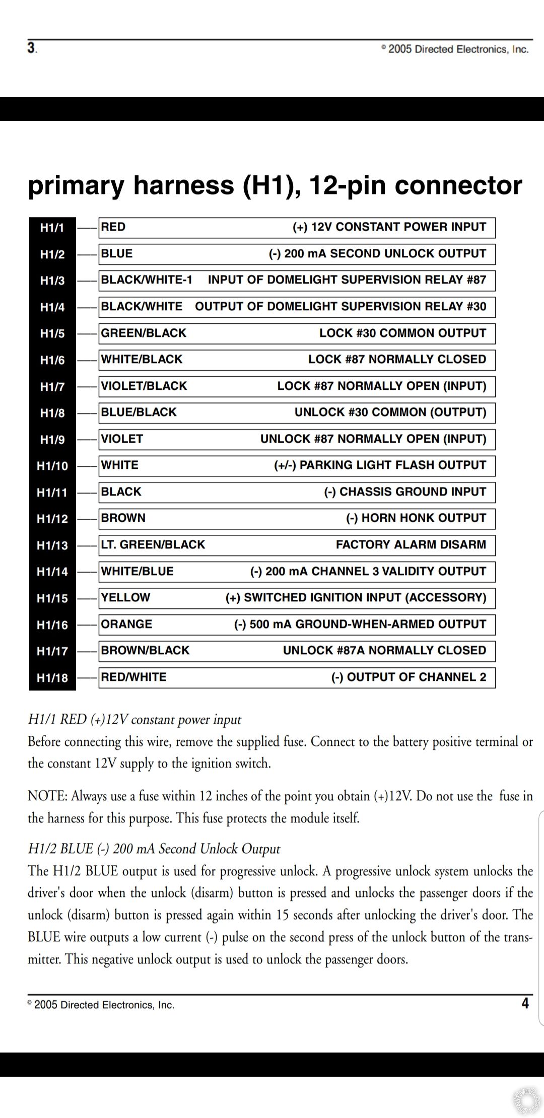

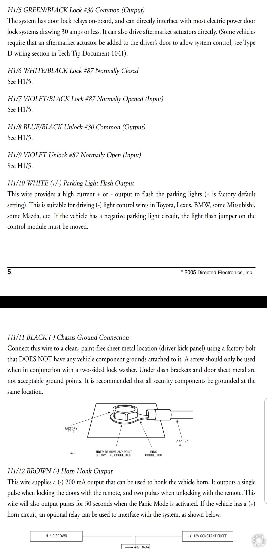

Post some instructions so we can see the wires listed.
Steve G
jlutz455
Member - Posts: 9
Joined: August 14, 2019
Posted: August 26, 2019 at 4:31 PM / IP Logged Link to Post Post Reply Quote jlutz455
Viper 211HV, Actuator Wiring with No Locks on 73 Trans Am -- posted image.Viper 211HV, Actuator Wiring with No Locks on 73 Trans Am -- posted image.
iskidoo
Silver - Posts: 1,046
Joined: December 08, 2002
Posted: August 26, 2019 at 5:46 PM / IP Logged Link to Post Post Reply Quote iskidoo
Both (H1/7) and (H1/9) #87 normally open wires to +12v constant.
Both (H1/6) and (H1/17) #87A normally closed wires to chassis ground.
Connect (H1/5) Lock 30 to one actuator wire and the (H1/8) Unlock #30 to the other actuator wire.

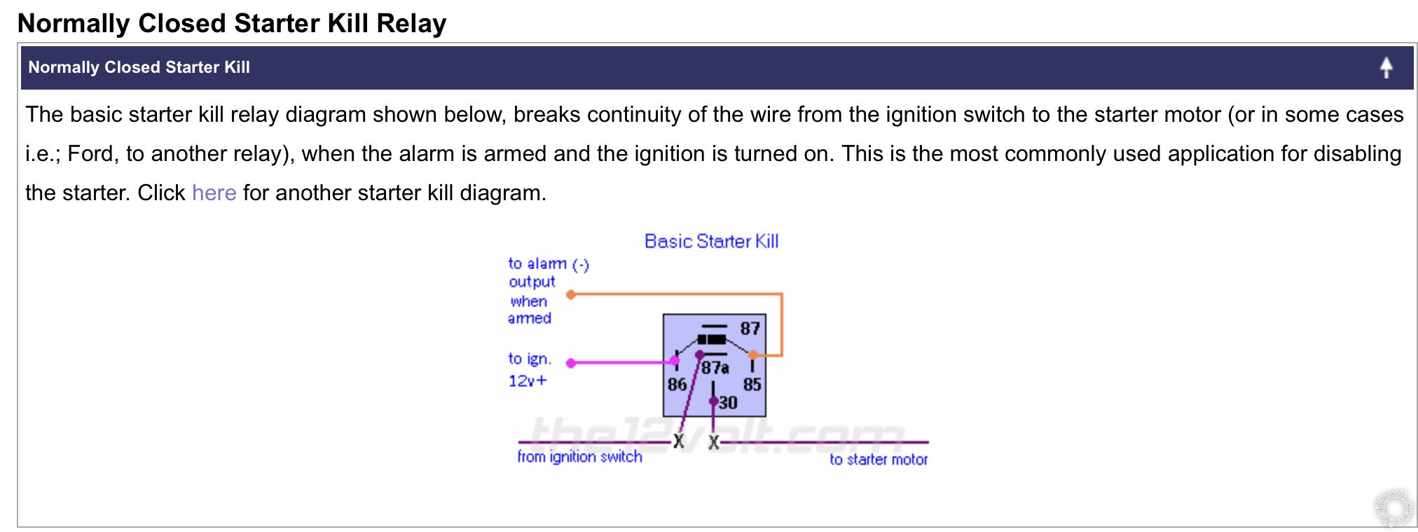

Steve...I setup a bench test hooking up the wires as you mentioned and it works great. Another question is the H1/16 orange wire called “(-) 500 ma ground when armed. Is that for a starter kill when armed and I should wire like this... Viper 211HV, Actuator Wiring with No Locks on 73 Trans Am -- posted image.
iskidoo
Posted: August 29, 2019 at 9:51 PM / IP Logged Link to Post Post Reply Quote iskidoo
Glad to hear that. That diagram is exactly how you should wire it. Good job searching the site for the answer. Looks like you are on the right track.

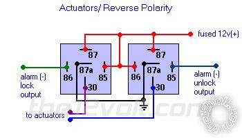

I think that would complicate things a bit. Normally you would connect 2nd unlock to the entire existing system that unlocks all doors at one time. Then you would isolate the drivers door from the rest and connect that to the regular unlock output. That would require another set of relays to control the driver actuator. This 211HV unit having built in relays makes it more difficult. You would need a 451M or a pair of relays wired to each individual actuator like this.
You could then wire your lock output from the 211HV to both pairs of relays. Then the unlock would wire to the drivers pair of relays and the 2nd unlock wire would go to the passenger side pair of relays.
Essentially you would no longer be using the 211HV internal relays to operate the actuators. You would be using external relay pairs for each side. The reason being that the lock output needed from the 211HV to control the passenger side relay pair is internal and I can’t think of any way to get a locking output for the 2nd actuator.
Maybe there is a way to do it keeping the current setup but I am not able to think of it. Hopefully someone else may be able to chime in if they can figure out how to do it.
Personally I would just keep them the way they are due to the added work involved, but that is up to you.
