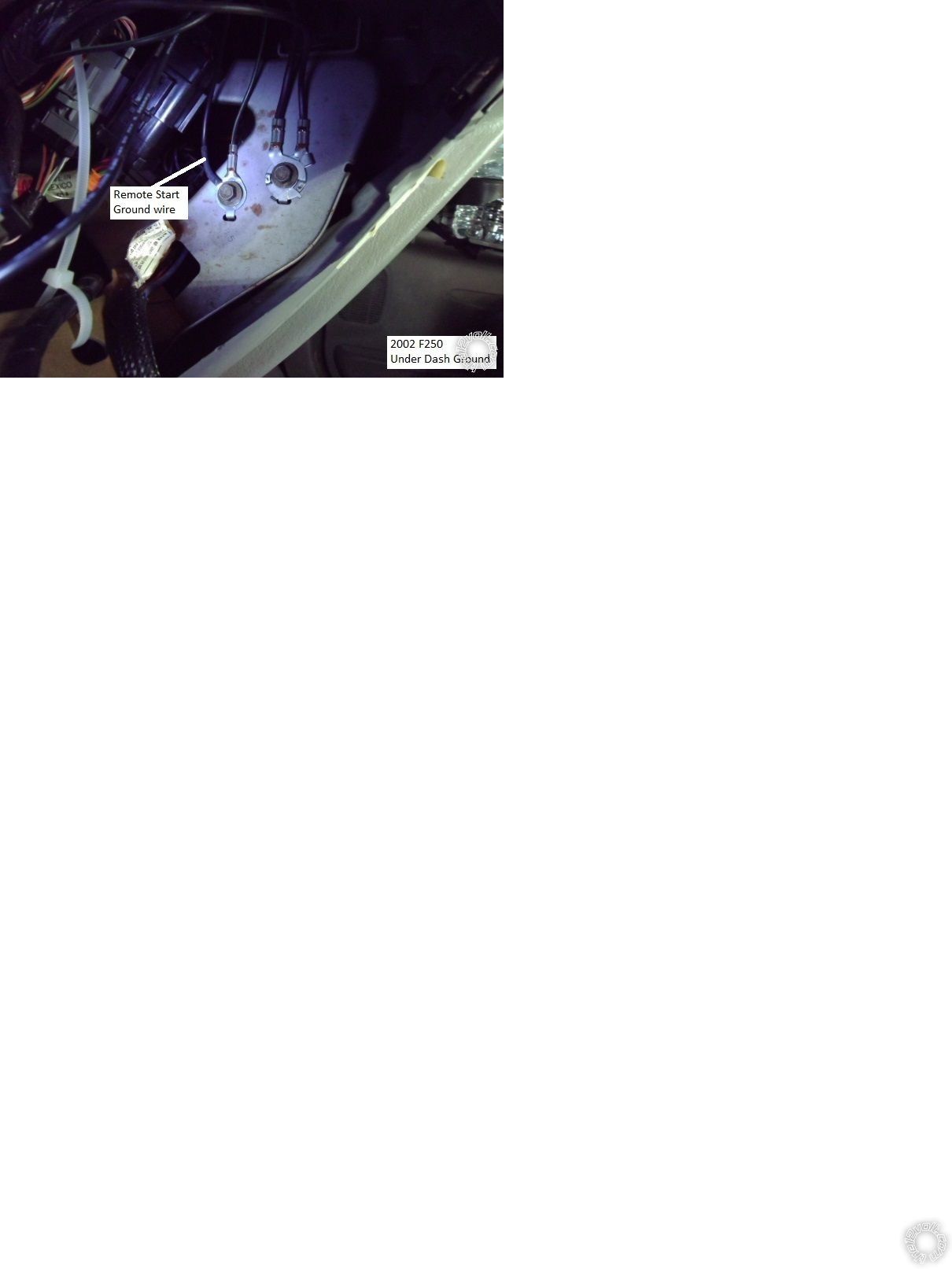

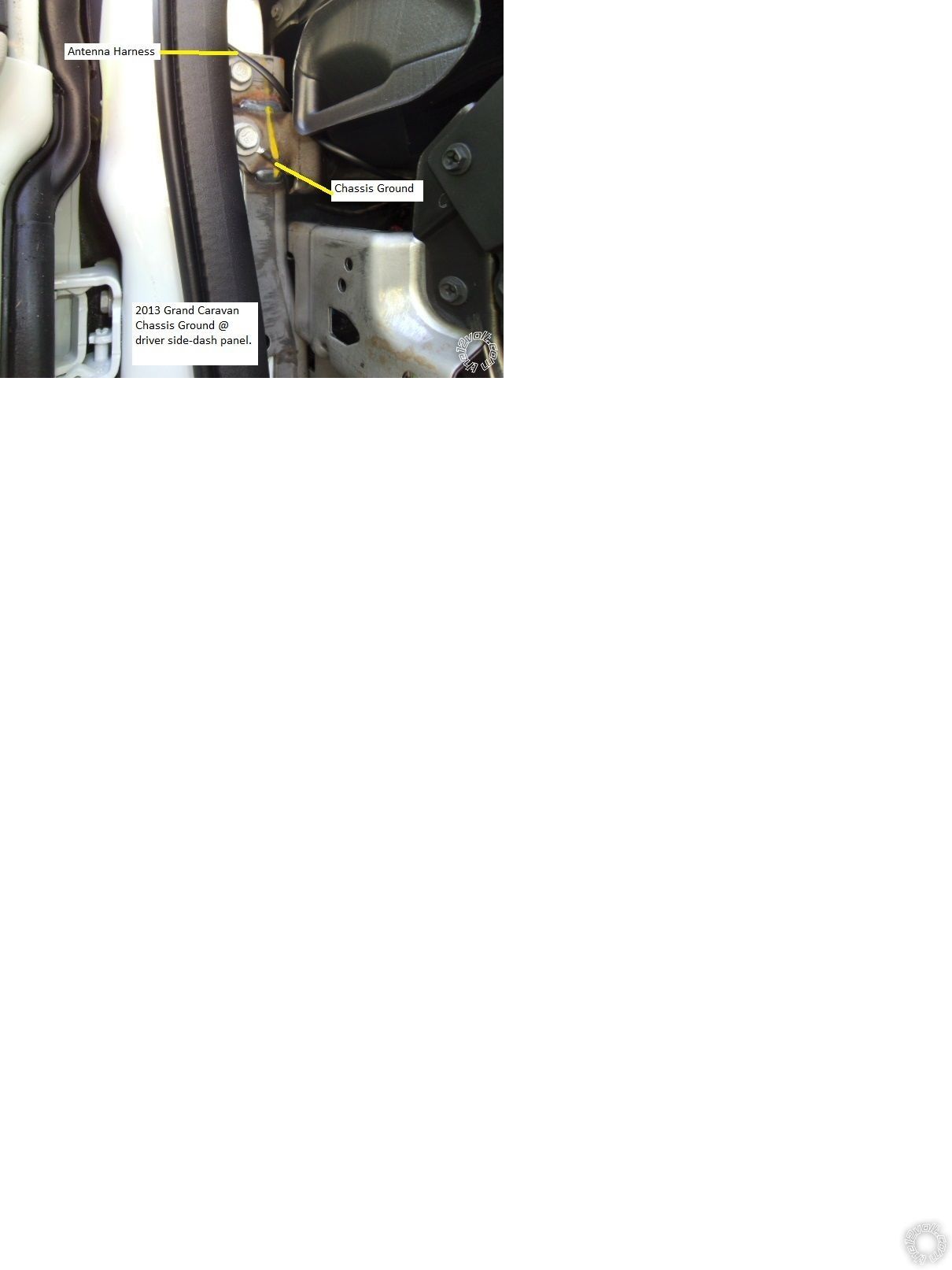

No, I was just trying to ask a question to clarify that because that's what I thought as well. I didn't think I needed the high current harness looking at this guide. So my application doesn't need a high current harness basically. I'm just trying to get clarification on this from somebody that knows more than this than I do because my last car needed a high current harness and I used a Viper remote start, not an idata kit. Also do I need to drill a hole for the ground wire in something metal on the car or is there someplace that I can ground the DC3 brain to without having to drill a hole any ideas on what I could use for a ground if I have to drill a hole I will but I'd rather not. Also one other question. The guide says to cut the green/white wire at the BCM that's for immobilizer data and attach the white/black wire to it for the immobilizer data vehicle side (DC3-M5 socket) wire on the DC3 brain and then connect the other side of the cut wire at the BCM to the white/red wire to the immobilizer data connector side. When the guide specifies vehicle side they're talking about the wire coming out of the BCM and when they specify the connector side they mean that same wire except since ill be cutting it they want me to connect to the side of the wire that goes away from the BCM to the connector. Correct? That's how I'm interpreting that. I wanted to make sure my interpretation of that was correct.
Platinum - Posts: 7,828
Posted: November 13, 2019 at 2:52 AM / IP Logged Link to Post Post Reply Quote kreg357
For the R/S Chassis Ground connection you want a very "solid" ground. Obviously the best
choice would be with a soldered on terminal lug connected to the (-) battery terminal. That
is typically overkill. If you look around for a convenient location under the dash, near
where the R/S unit will be placed, you can usually find a Factory ground point where
several factory wires are bolted to the frame of the vehicle. You could use that connection
point with a soldered on terminal lug on the R/S ground wire. Basically any solid frame
location will work, I try not to drill holes in the customers cars but there are times
when it's necessary. Usually there is a shiny 3' diameter pipe under the dash across the
vehicle that is a solid ground point. You could drill a holes in this pipe and then use a
self-tapping screw to secure the R/S ground wire ( with a soldered on terminal lug ).
Last choice is to find a convenient location in the firewall or kick panel, use a wire
brush to remove the paint and then a self-tapping screw through the soldered on terminal
lug of the R/S's ground wire. Just ensure there is nothing on the other side of the metal
panel that the self-tapping screw will hit. Here are some ground location photos :
2015 Chevrolet Spark LS, Remote Start -- posted image.
