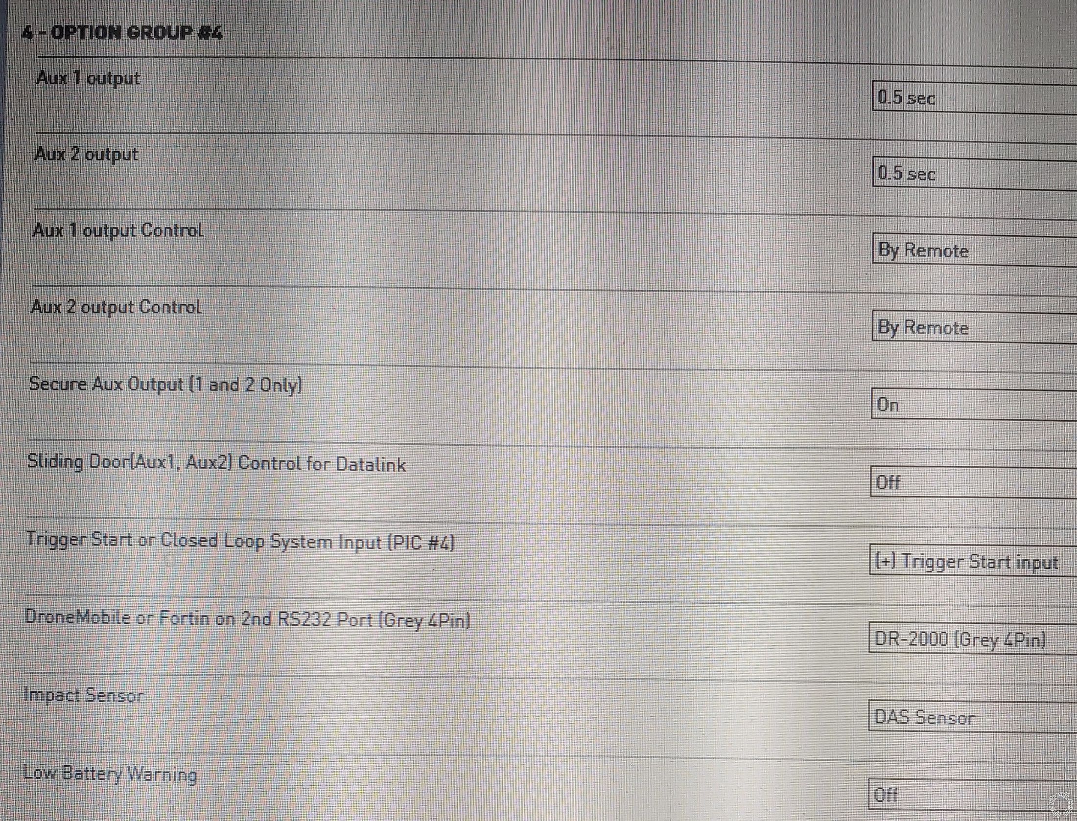

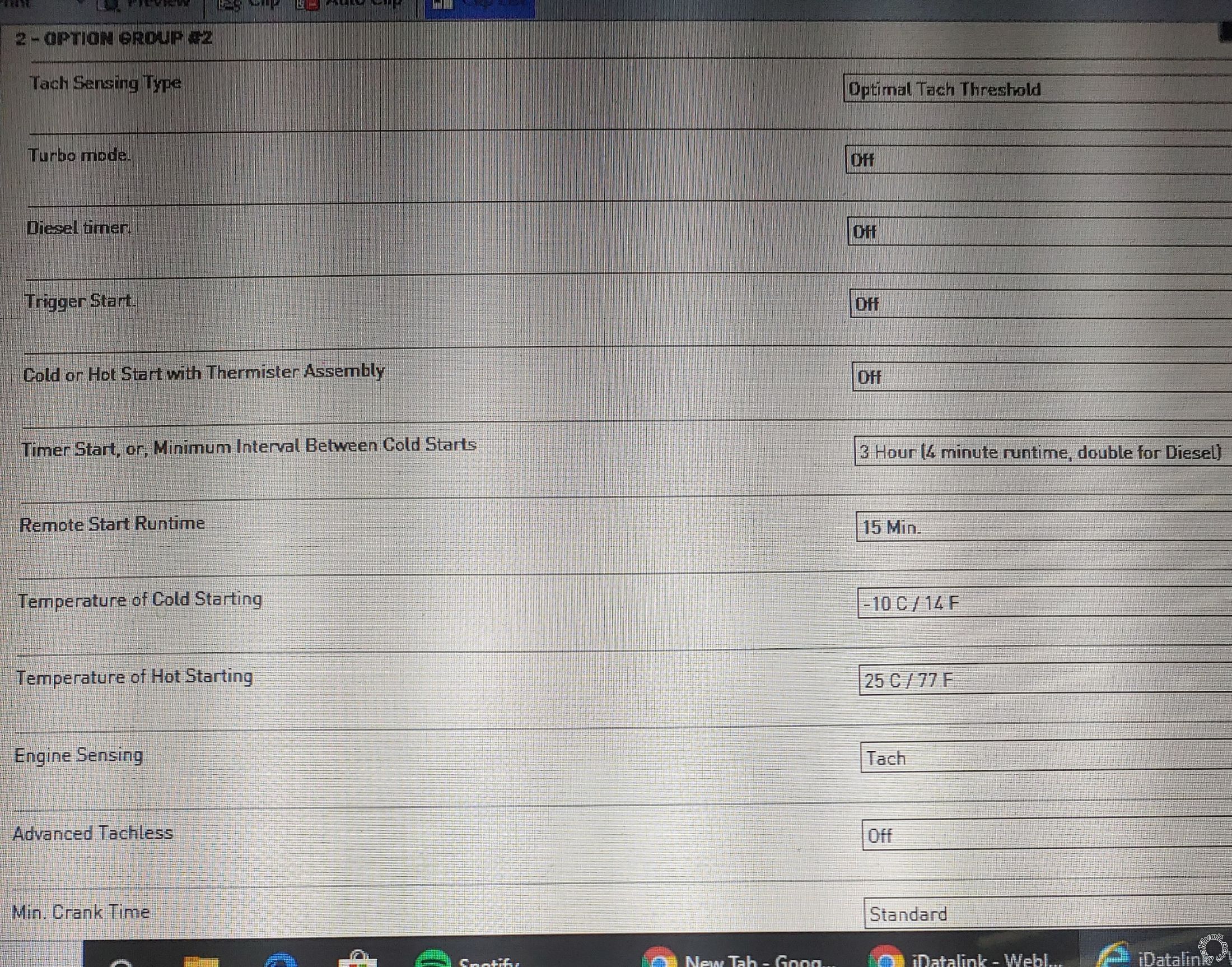

Ok so i reset it and still no light after initiation of program/ learn sequence. Here is how i have the alarm brain set. I did not see an option for 2-10 engine sensing so I set it to tach vs tachless as before.

Set engine sensing to no connection assumed run still nothing. It wont initiate the program sequence, so not sure where to go from here.

Did the 16 Step Blade AL programming complete properly as per the guide?

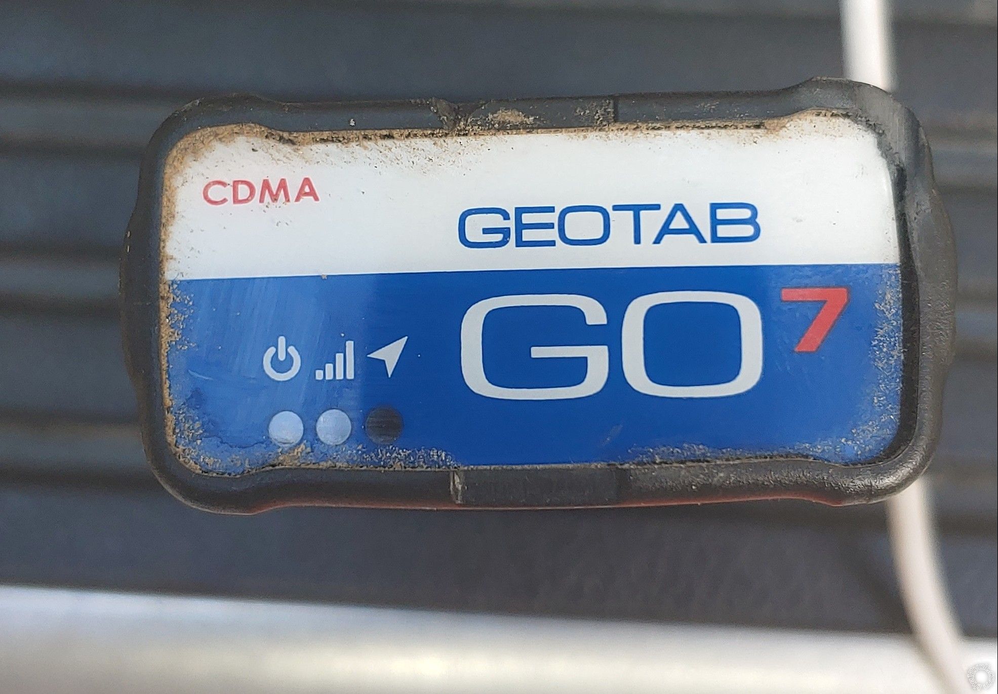

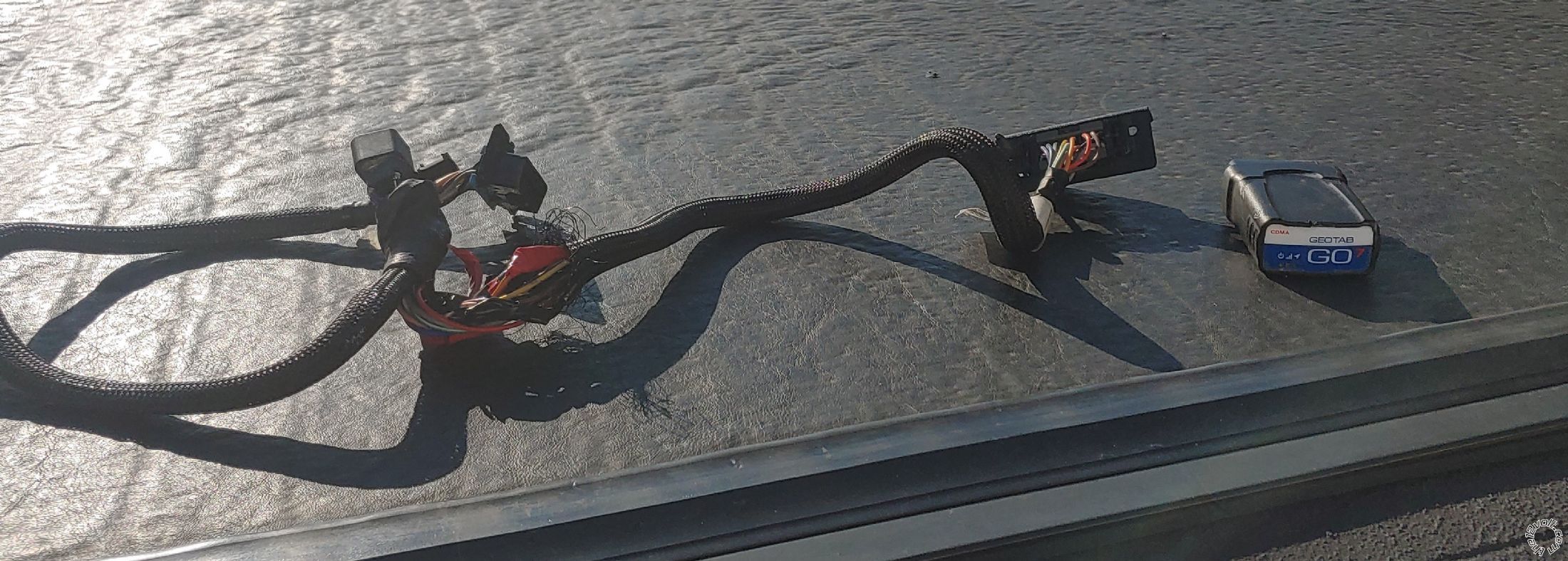

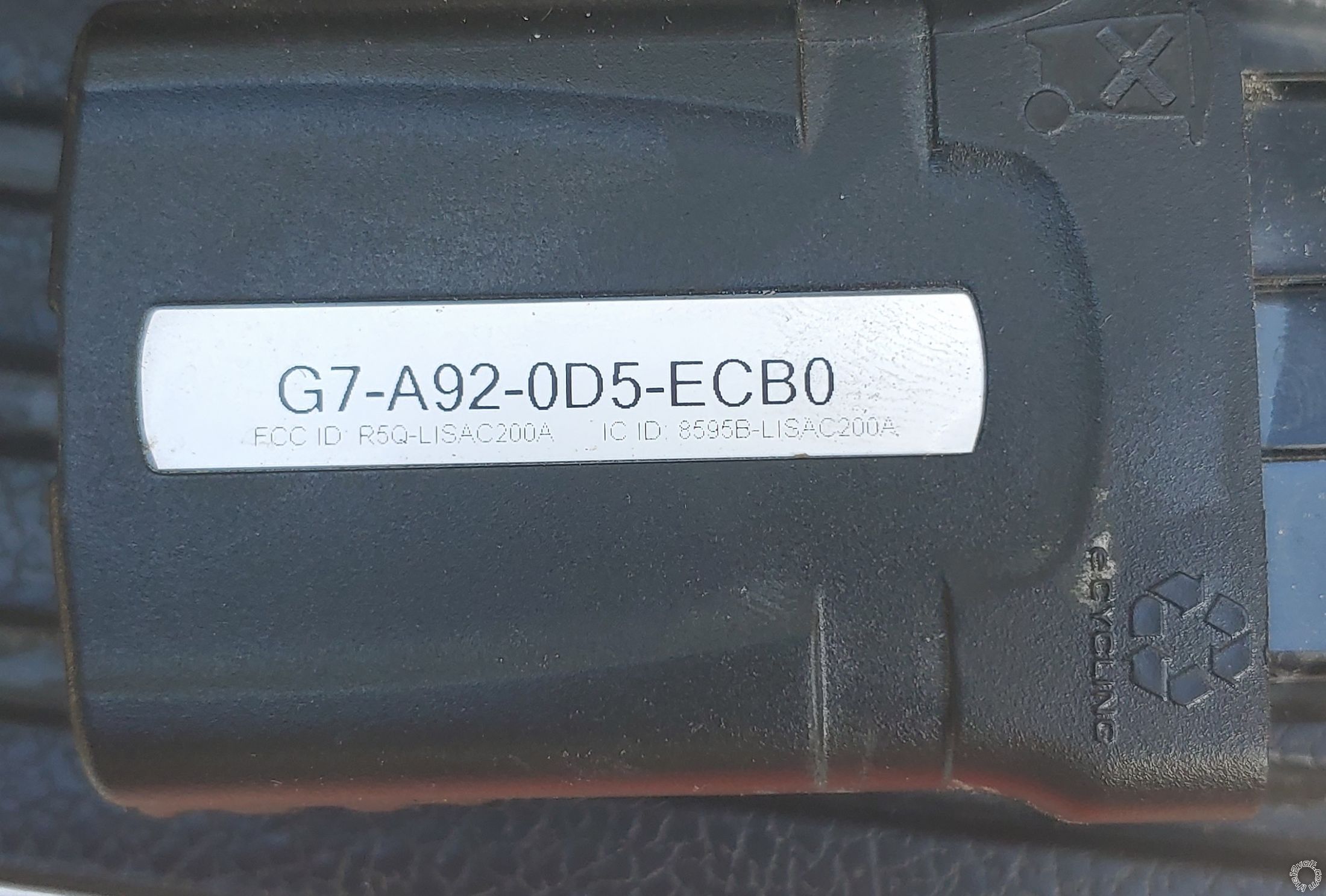

Ladies and gentlemen I present my issue...
To those of you who don't know what this is it's a vehicle tracker... I didn't put 2&2 together till i saw the word GEO and the signal bars. This is why my wiring was always jacked up and when corrected still nothing.
Back to the story. Success!!! So i now have remote start. While in for firmware I set the alarm brain to use a DAS sensor for sensing break- in attempts.
