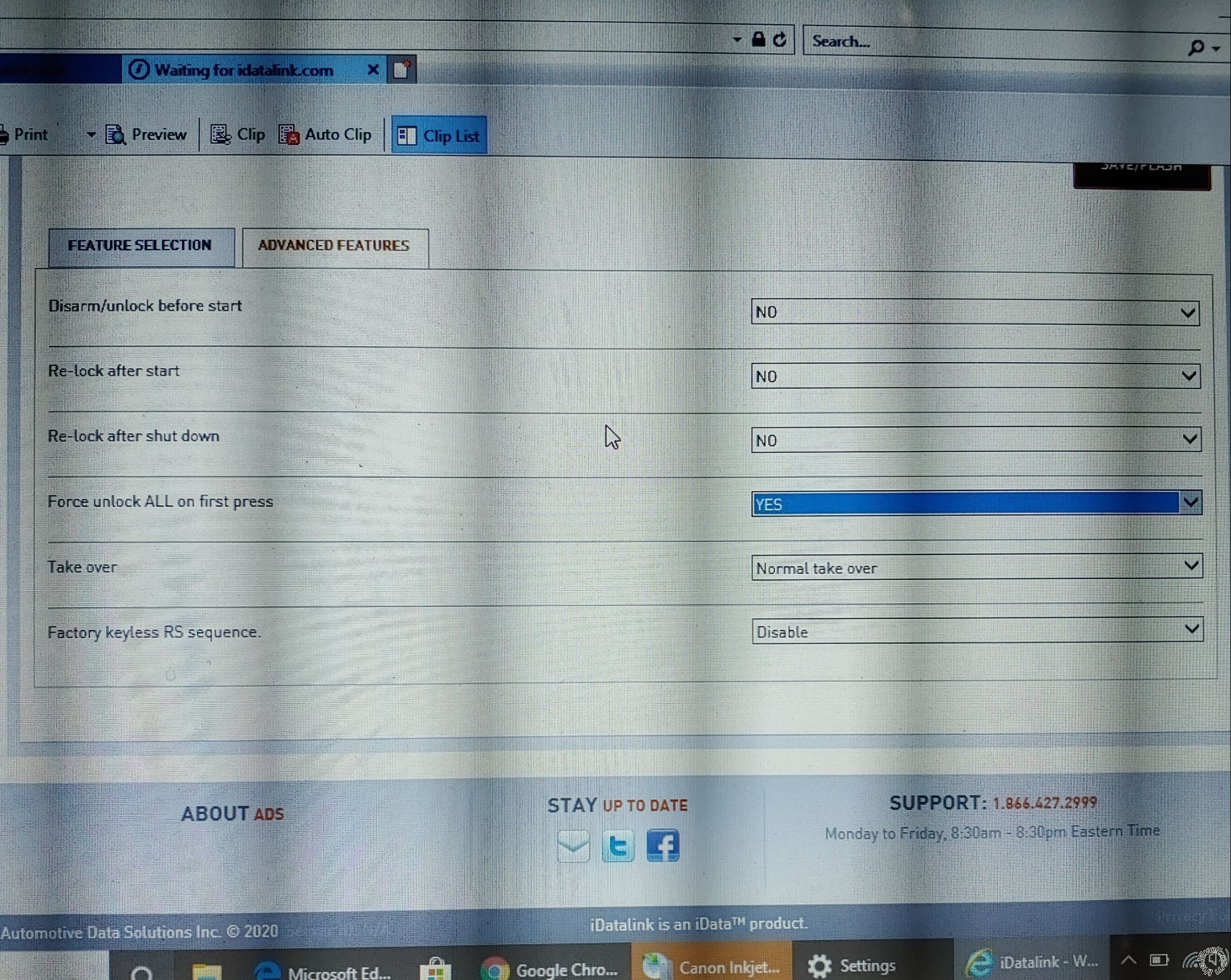

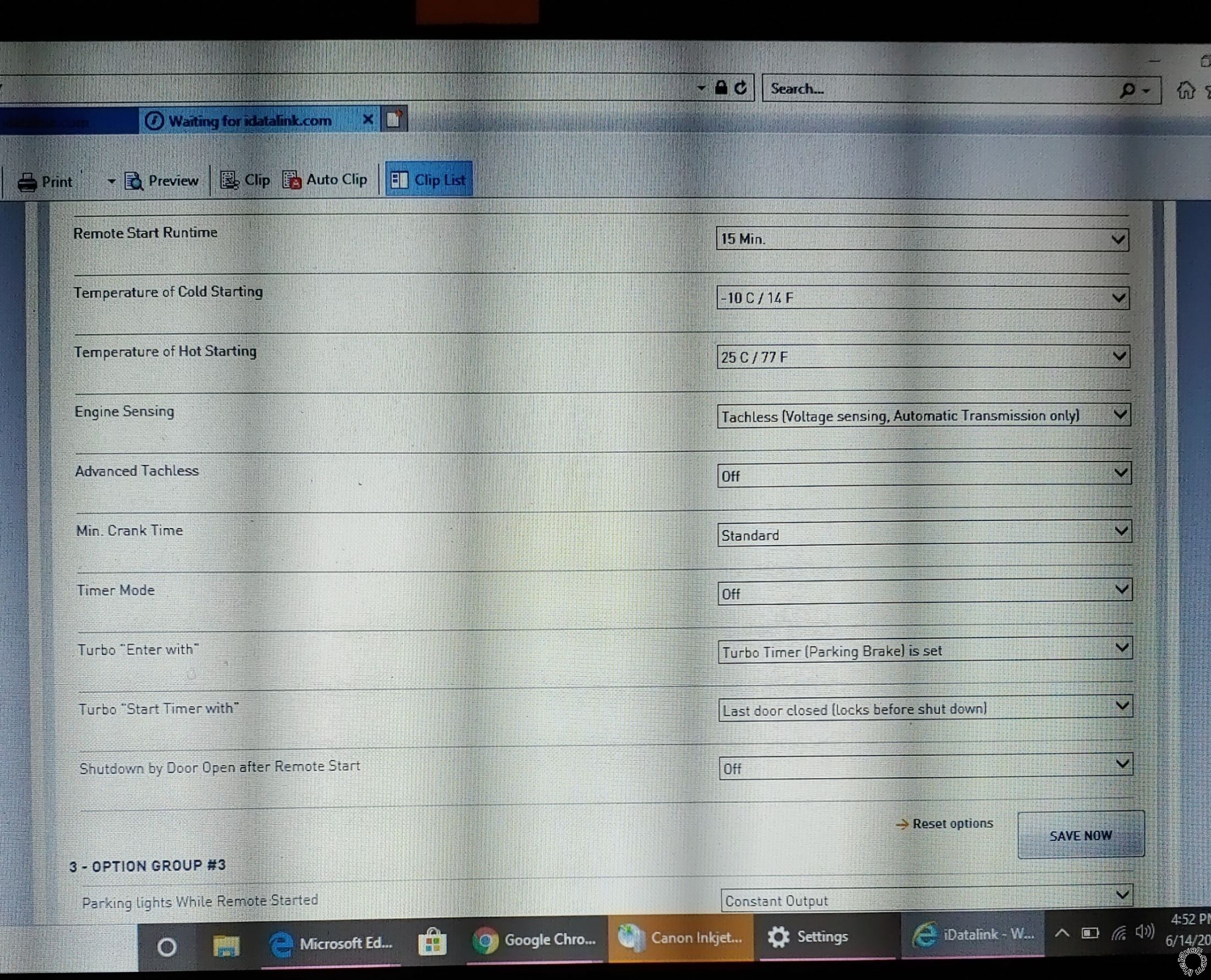

Ok i flashed it without the onstar and factory alarm. I tried to upload pics of the changes made to the flash. Some reason they wont upload and they are sized correctly.

For the tach i figured id keep it simple and go off voltage instead.

2014 Chevrolet Silverado 1500, Remote Start Alarm? - Page 7 -- posted image.

Personally, being as your truck has "one-touch-start", I would go with Option 4 for 2-10 Engine sensing. Let the truck do the work.
