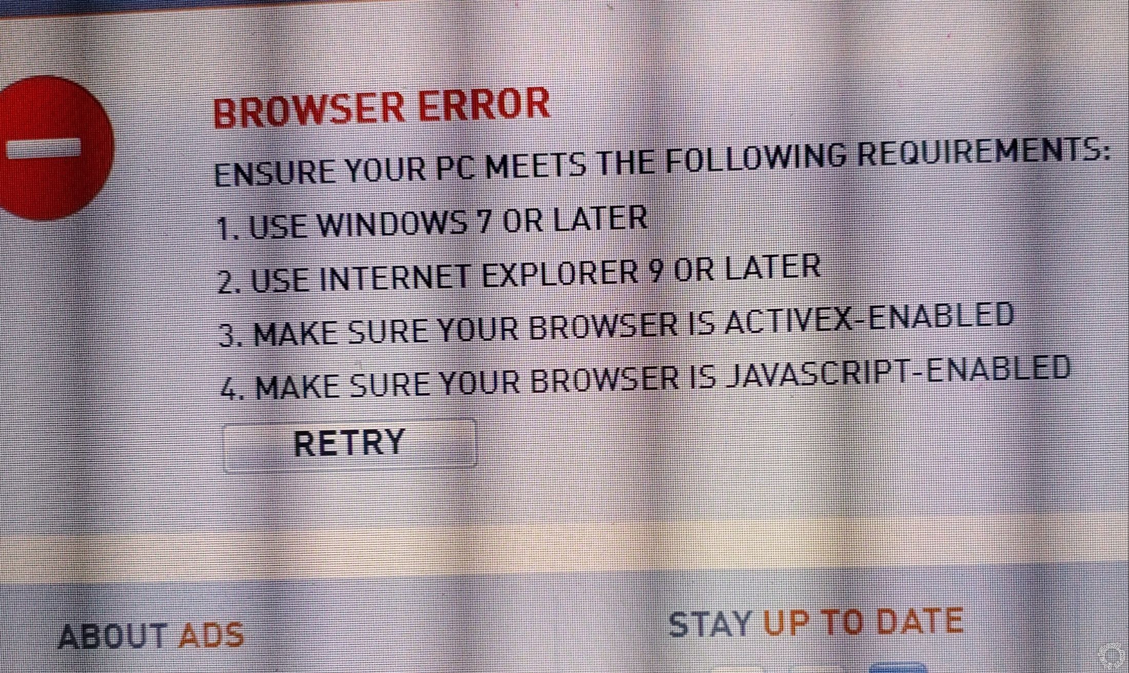

Posted: June 14, 2020 at 4:01 PM / IP Logged Link to Post Post Reply Quote snow camo
Ok ive started an account. Downloaded the program and when i hit the flash your module link and get this brozer error 2014 Chevrolet Silverado 1500, Remote Start Alarm? - Page 6 -- posted image.

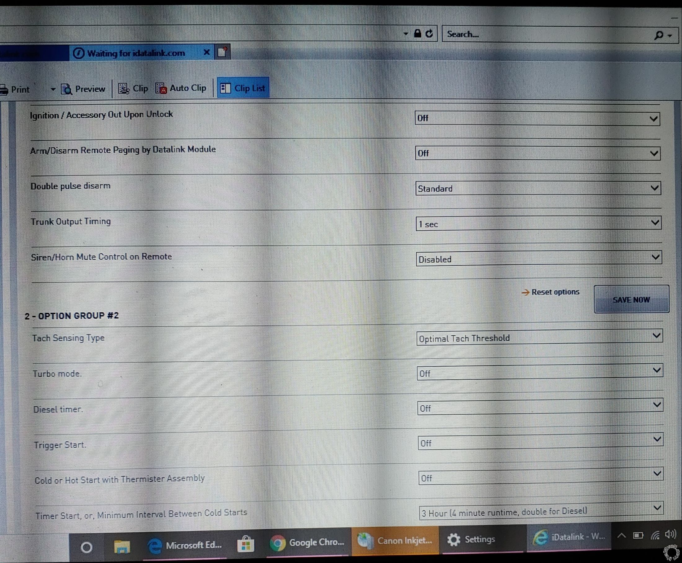

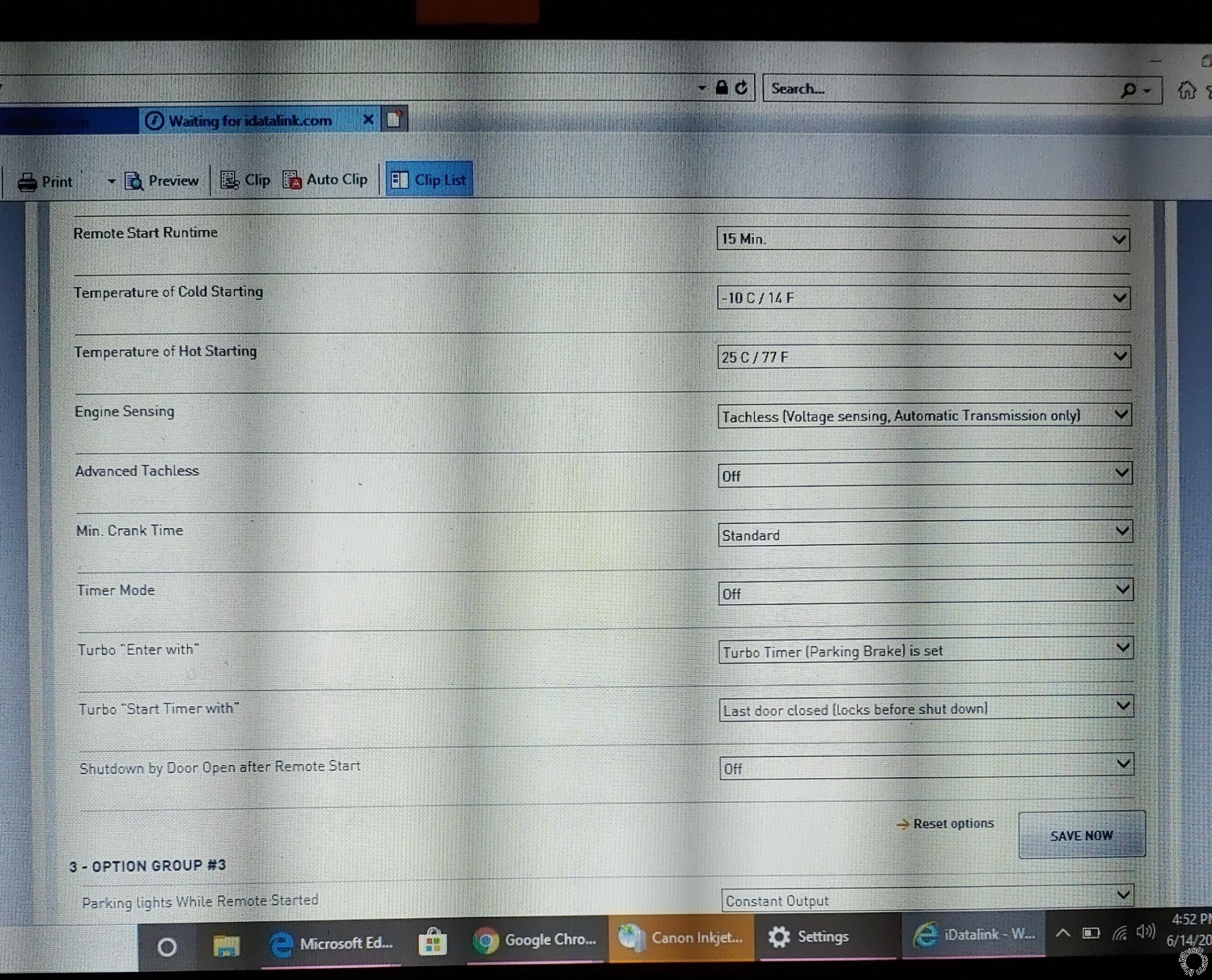

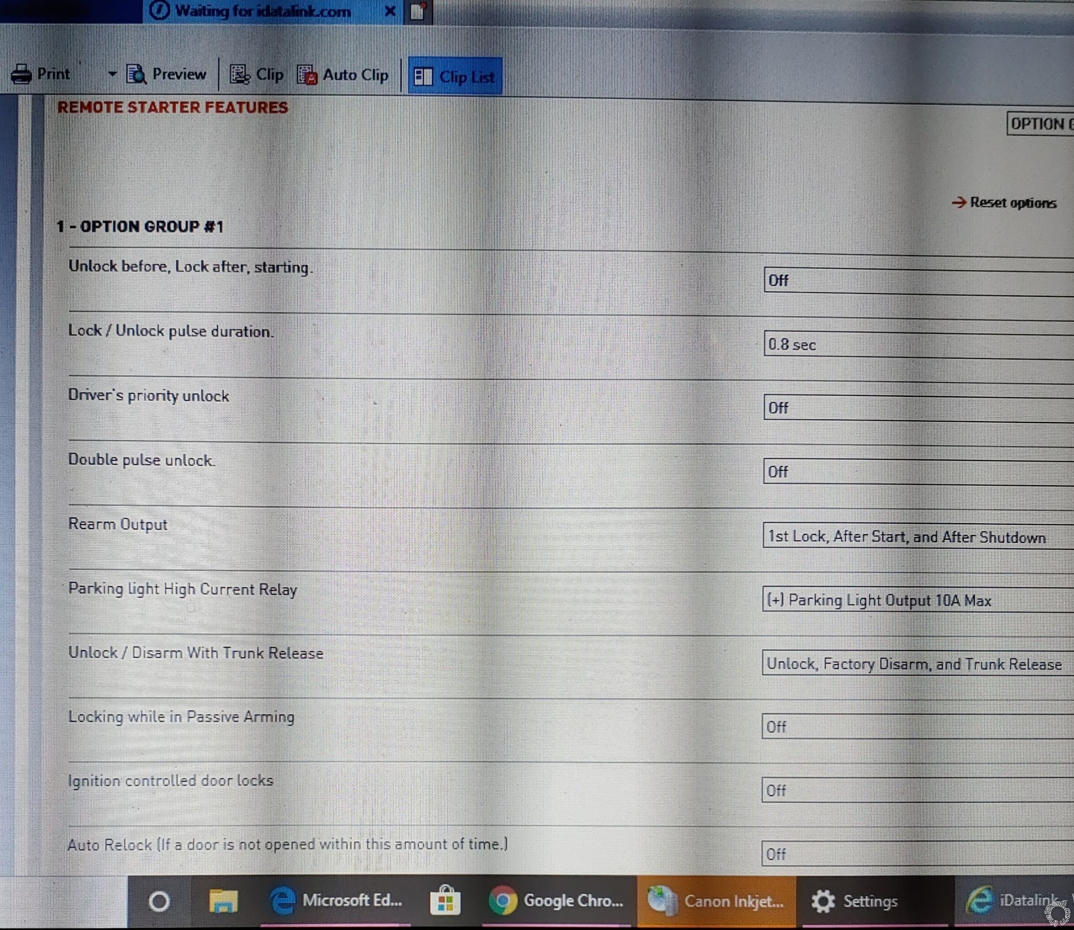

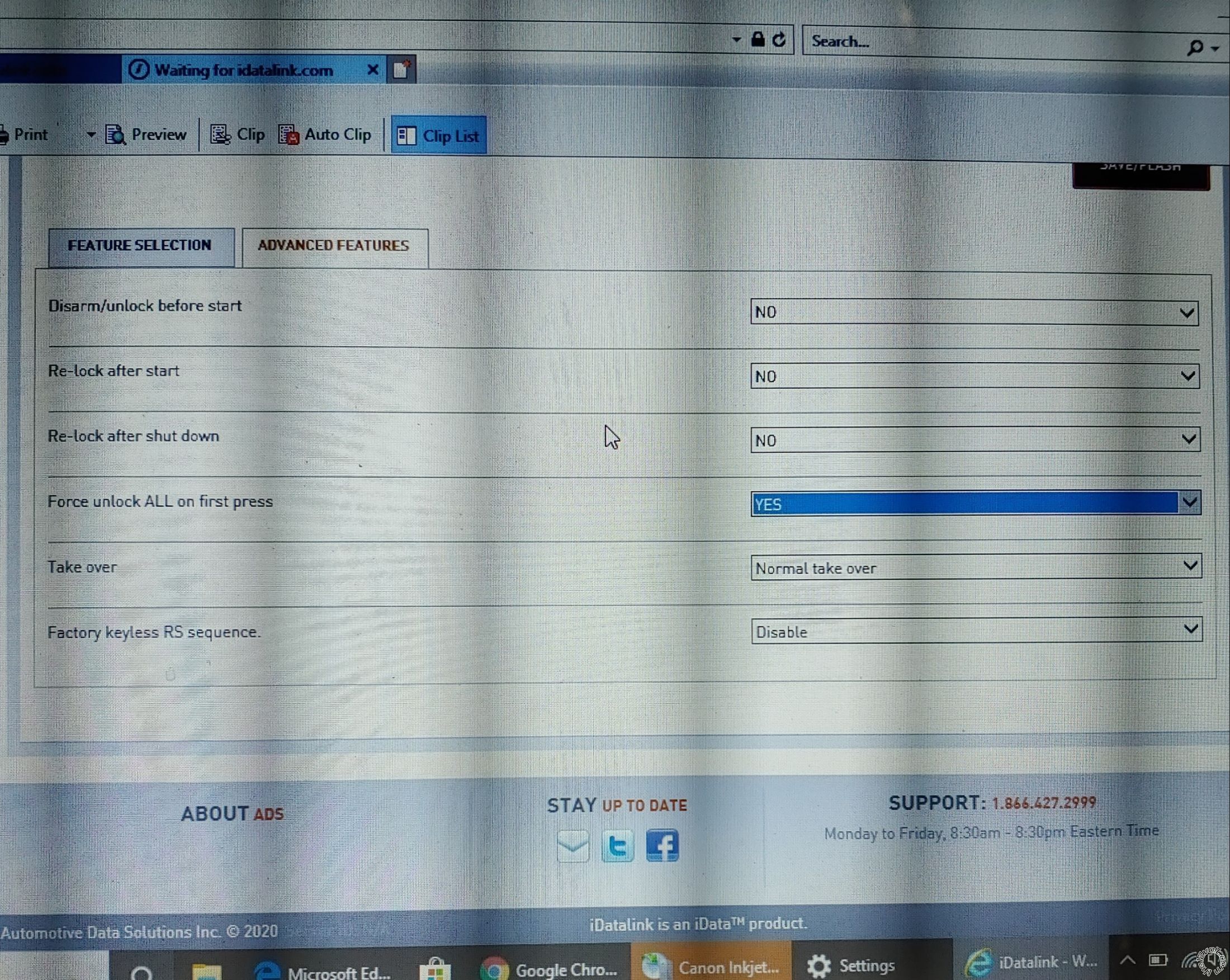

Ok im going through the firmware options for the blade and remote start alarm.
snow camo
Copper - Posts: 55
Joined: December 19, 2019
Posted: June 14, 2020 at 5:08 PM / IP Logged Link to Post Post Reply Quote snow camo
