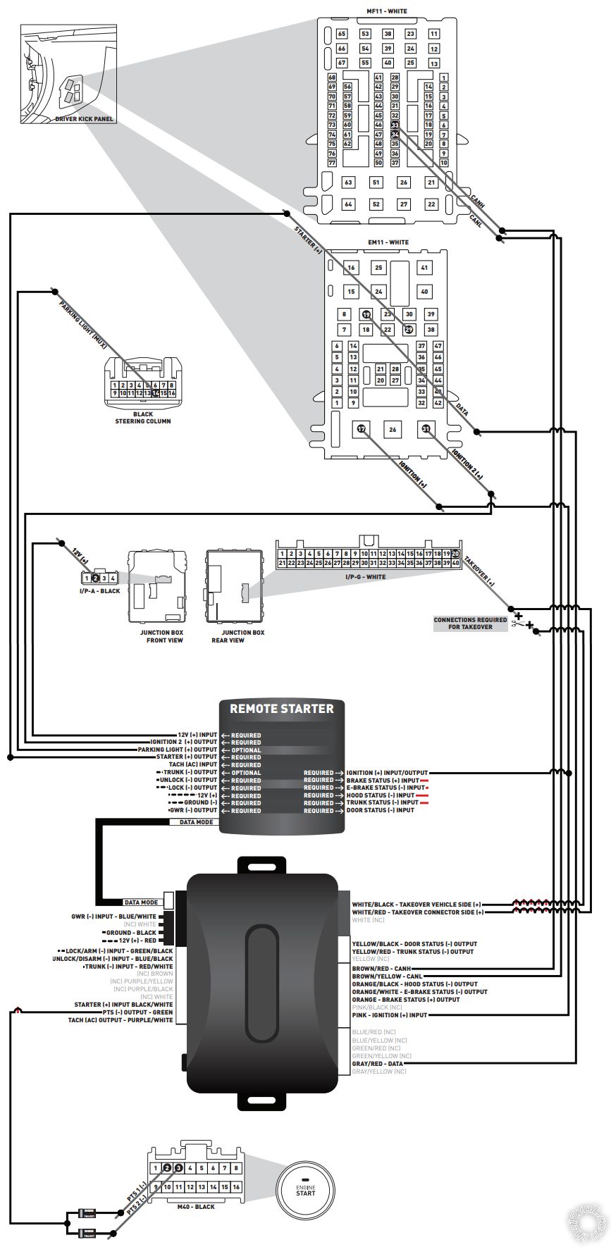

Does your installation for the Astra A777 and iDatalink Alca look like this:
2015 Hyundai Sonata, Security and Remote Start -- posted image.
dhall764
Member - Posts: 14
Joined: March 08, 2020
Location: Maryland, United States
Posted: March 13, 2020 at 3:36 PM / IP Logged Link to Post Post Reply Quote dhall764
Yes it does,my problem is trying to figure out what to flash on my idatalink alca I've already flashed it 2 way. It would crank once but not start, would that be possibly be a tach wire.?
