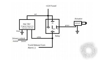

I am very much interested in using the PAC TR-7 with hornet. How would I go about the wiring? I was reading the user manual of pac tr-7. any help is welcome.

The PAC TR-7 would connect as follows:
Red to Fused +12V constant
Black to Ground
Green input to the Driver's door unlock motor (UNLOCK MOTOR|YELLOW /GREEN|back of the fusebox, Top left plug or Driver's Kick)
-This wire will remain at ground, pulses to 12V when you unlock with the door switch or the remote.
White (-) output to relay pin 85
(Numbering typo from above post----numbers should be should be 85 & 86, not 35 & 36)
Relay connections:
Relay Pins 30 & 86: +12V Fused Constant
Relay Pin 85: Hornet H1/12 Red/White (and/or TR7 White lead)
Relay Pin 87A: Not connected
Relay Pin 87: solenoid + lead
A figure of this would be:
2005 Honda Civic, Remote Start Install -- posted image.
Your trunk solenoid would take the place of the actuator in the diagram. If you don't end up using the Hornet Red/White to activate the remote start, you could also hook up the alarm's Red/White output to the relay pin 85 along with the TR-7's output if you want, no issues. Then either the factory remotes or the alarm's remotes would pop the trunk. Of course, just make sure that the alarm is not armed if you use the factory remote.
For TR-7 Programming, you would use Feature #14, Set it up to could 3 (unlock) pulses in 8 seconds.   There is a switch to place the TR-7 in program mode, and back to operational mode when you are done.
Programming the TR-7 can be frustrating, I recommend using a push button switch to program it on the bench before installing. If you make a mistake, just power off and on and restart the programming.
Be patient and follow the PAC guide and you should be OK.
