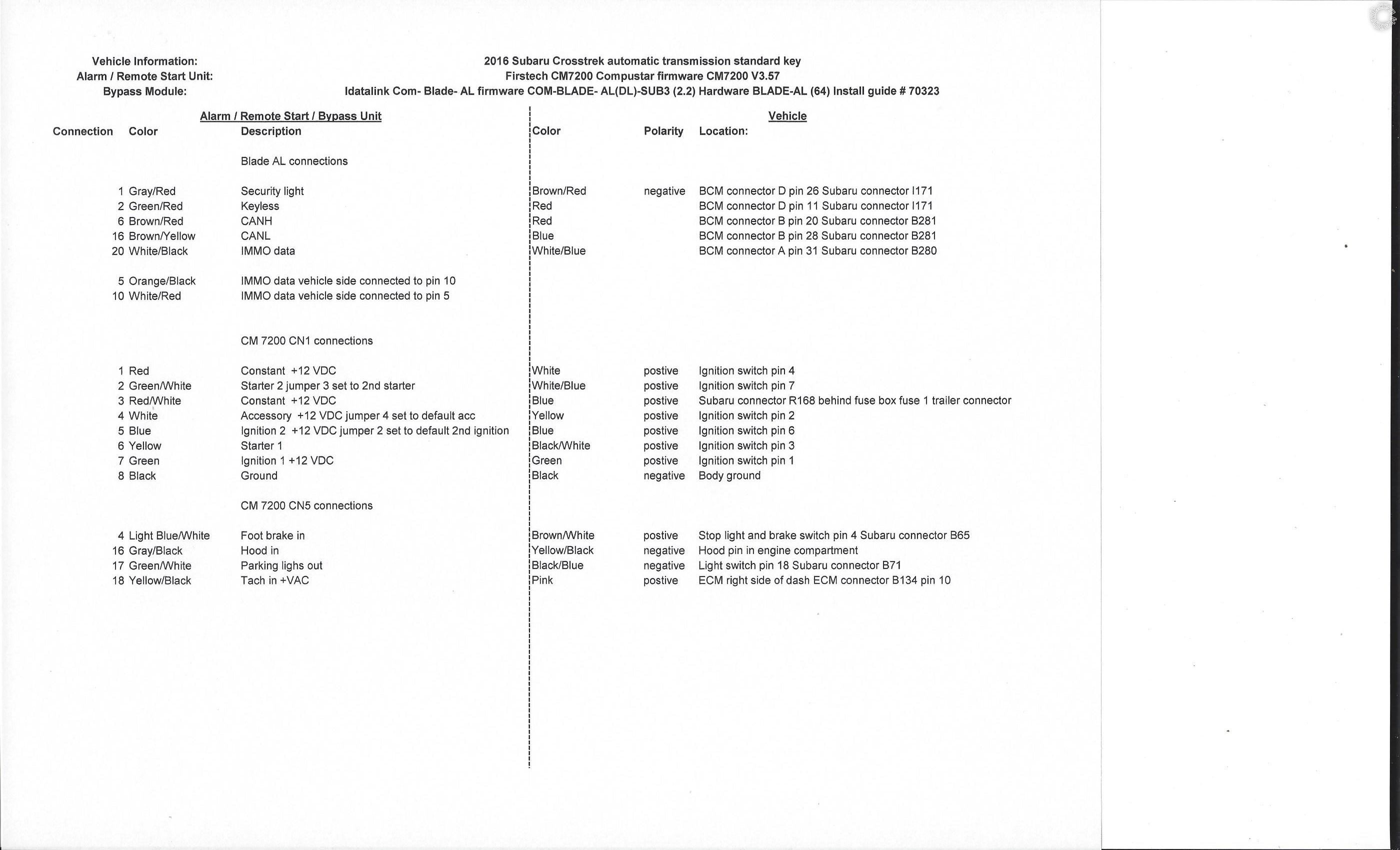

First post here installing a remote start in a 2016 Subaru Crosstrek automatic transmission with key ignition and factory alarm.Remote start components Firstech CM7200 control module,Idatalink Blade AL cartridge ,Compustar 2W901R-SS remote.Flashed the control module and Blade AL KLON part 1 of 2 was completed. Connected the high current harness CN1,Blade AL harness CN4,CN5.Jumper 1 at default negative door trigger, jumper 2 at default 2nd ignition. Set jumper 3 to 2nd starter jumper 4 at default accessory.Checked CN1 for proper voltages at ignition off, on and start.Connected the remote starter did the module programming procedure steps 1-6 outlined in the Blade AL install guide #70323 programmed ok.Continued with step 7 did the extended KLON programming connected remote starter to vehicle successfully completed steps 10-14.Programmed the 2 remotes. Did the tach learning procedure parking lights flashed once indicating a good tach signal was learned.Tested the remotes can unlock,priority unlock,lock,and trunk(hatch) release.Activited the remote start the vehicle will start but shuts down in about2 seconds.I get error8 on the 2 way remote tach sensing failure.I have successfully relearned the tach signal several times.I have 2.5 VAC at pin 18 CN5 at 900 RPM voltage increases with RPM'S.Feature 2-10 engine sensing is set at default for tach.I tried tachless mode, advanced tachless and alternator sensing.Of course I would like to use the tach sensing method.See attached jpg for wiring diagram.  2016 Subaru Crosstrek, Firstech CM7200, Compustar 2W901R-SS -- posted image.

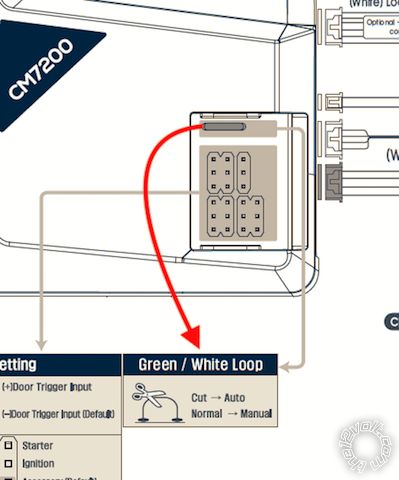

Remember to cut the "green/white" loop wire to set your CM7200 to AUTOMATIC transmission mode which is required for your Subaru Crosstrek. Re-learn tach once you cut the loop.

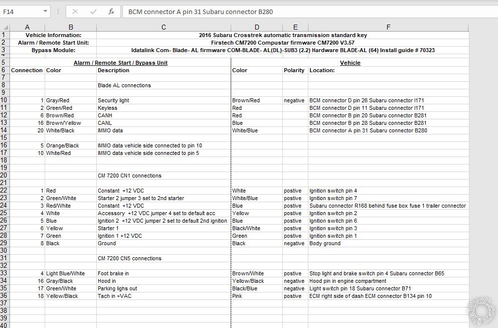

Also, in your Blade-AL spreadsheet, i do not see you made a connection to the following wires as indicated in the Blade-AL installation manual:
13 blue/yellow Keyless Relay (-) output
15 orange/white Security Light (-) vehicle side

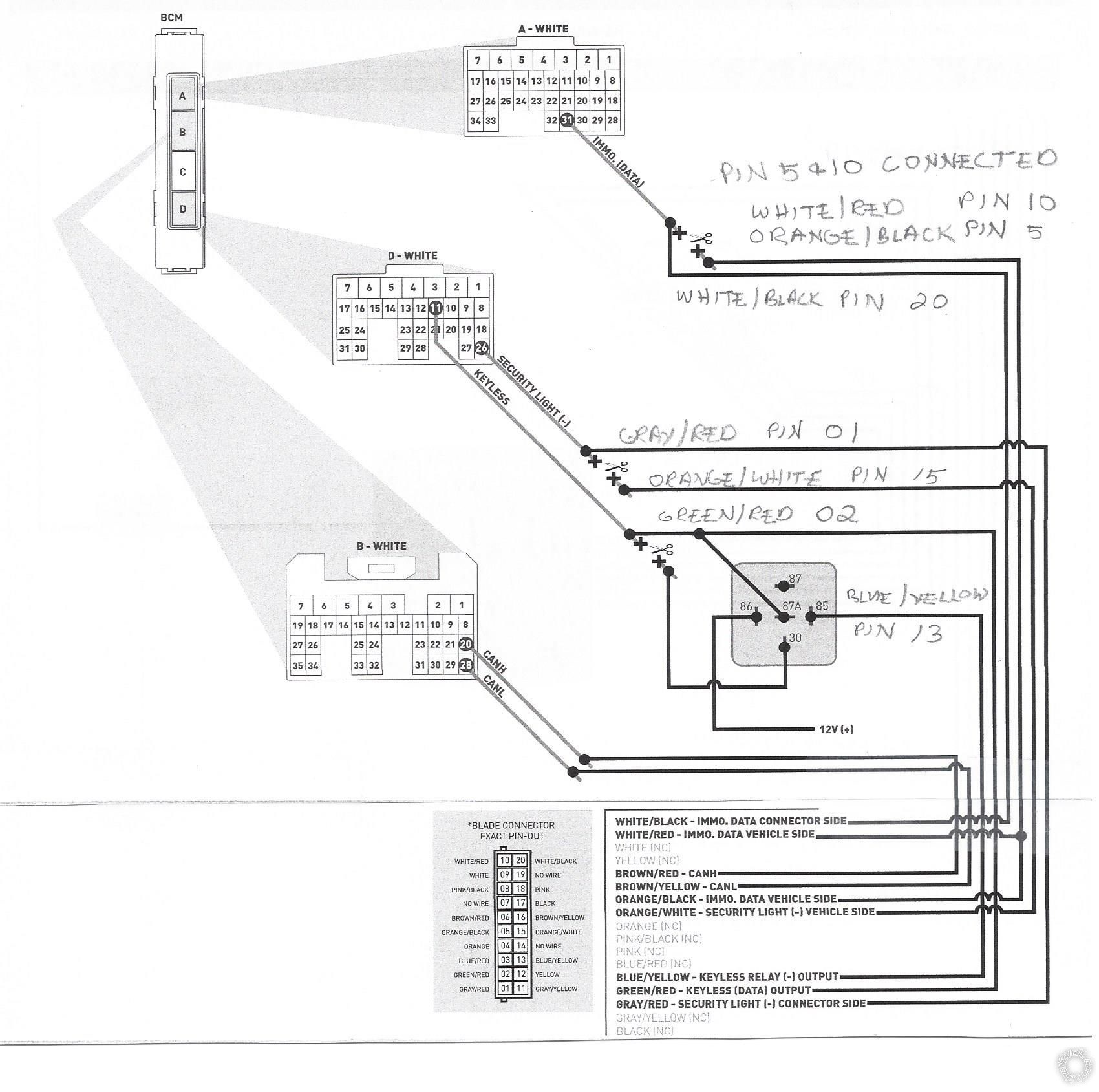

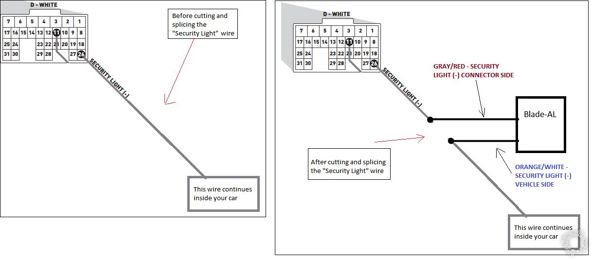

i appreciate your honesty but please keep in mind that this installation diagram was created by the engineers in Firstech/Compustar, including the required testing and troubleshooting to make this remote starter system work for every 2016 Subaru Crosstrek out there. Please make sure that you connect every single connection to your vehicle as indicated in the Blade-AL installation manual.
the image below might help you understand the "security light" connection and the rest of the connections. Also, the suggested relay, wire splice, wire cutting by the Blade-AL is required, the relay must be wired according to the Blade-AL installation manual.

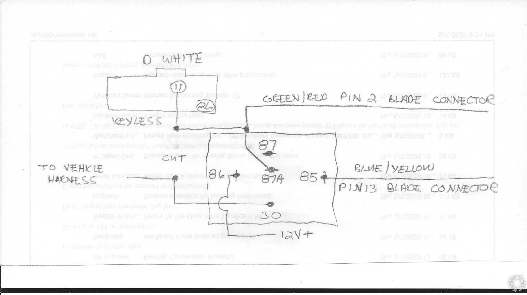

Hi guys after looking at your image it makes sense.I did not understand the connector side or vehicle side label in the install guide.I tapped into the wires for the keyless,IMMO data and security light only.I did not connect the vehicle side wire for the keyless,IMMO data and security light.So I will cut the 3 wires at the connector and connect both the connector and vehicle side wires.I will do a factory reset and vehicle programming starting from step 1.I attached a drawing for the keyless relay.As you said a image is easier to understand.Have to wait for the weekend to rewire everything its my daughter car she needs it for work.Thanks again, I will keep you posted. 2016 Subaru Crosstrek, Firstech CM7200, Compustar 2W901R-SS -- posted image.

Good afternoon all. Update on my remote start project.I did a factory reset and a complete module programming procedure with KLON as suggested by Kreg357 all steps completed with no problems.Next I finished with the incomplete wiring per djdeito instructions.The drawing provided by djdeito was a great help, thank you for that.Connected the following from the Blade AL 20 pin connector.Orange/Black pin 5,White/Red pin 10 to IMMO Data vehicle side.Connected Orange/White pin 15 to security light vehicle side.Connected Blue/Yellow pin 13 to coil on keyless relay terminal 85.Finished wiring the keyless relay terminal 86 to 12 +VDC,terminal 87a NC to Green/Red pin 2 keyless data output to connector side,terminal 30 to keyless data output vehicle side.Reprogrammed tack signal.Remote started the car, no issues. All the remote functions work.The only issue I see is the doors did not lock after remote starting the vehicle.The re-lock after start feature in the Blade AL is set to yes,disarm/unlock before start is set to no.All the features in the Blade AL module are set to default with the exception of RAP shutdown control is set to off.I assume the Blade AL would control this function.I have no wires connected to the CM7200 to control any door function.Any thoughts on this would be appreciated.Thanks for all the help.
