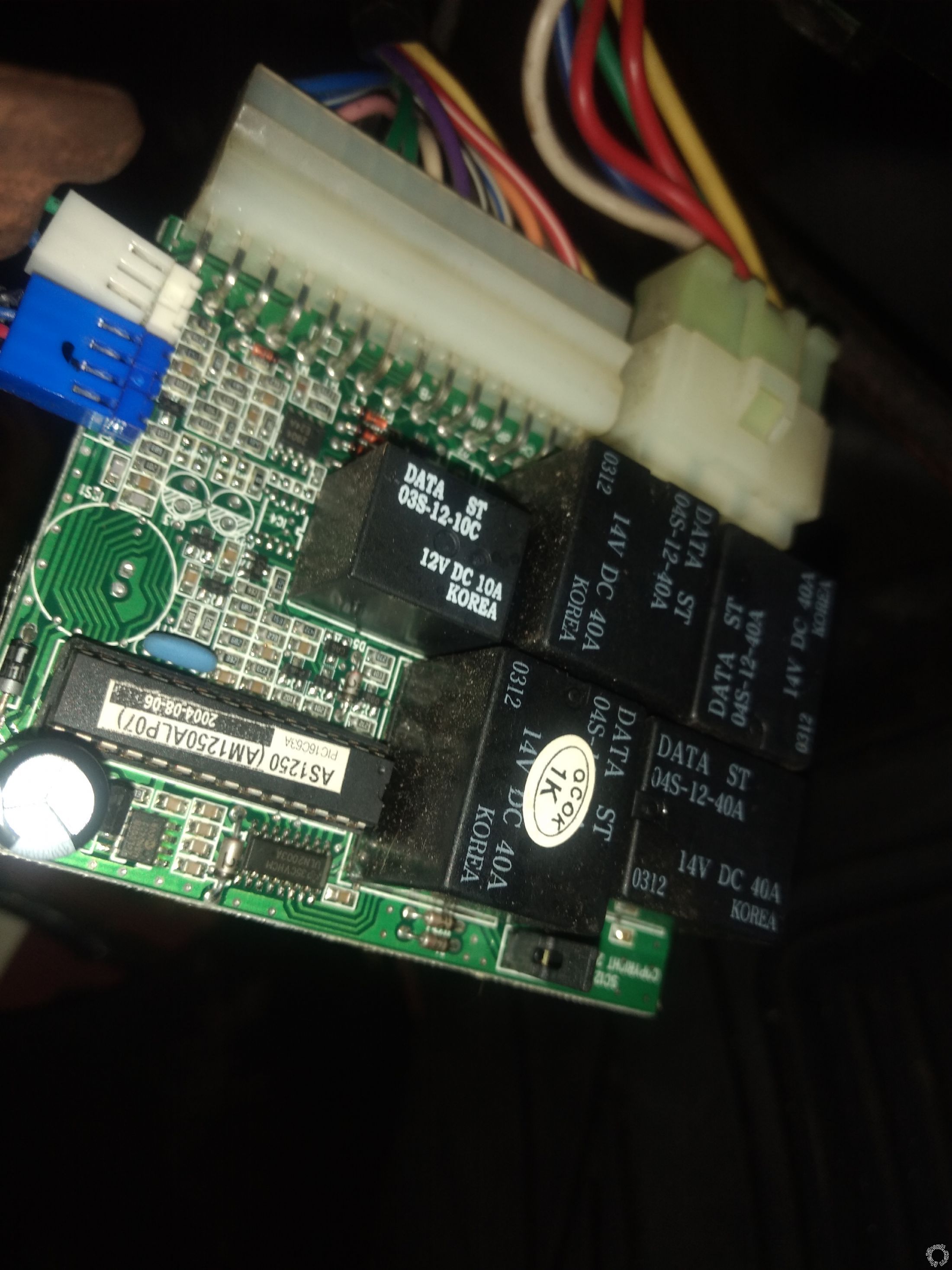

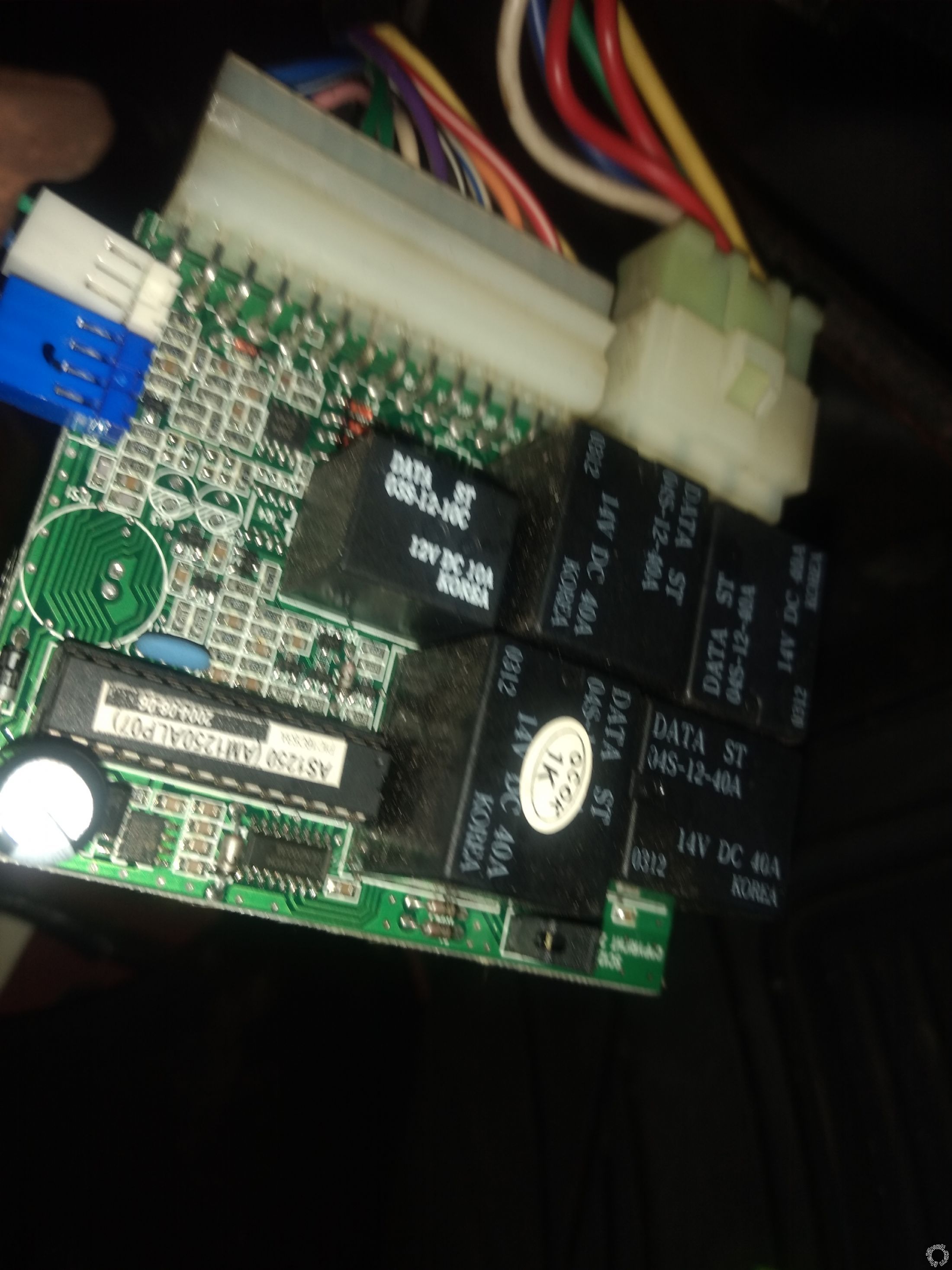

Well I opened it up and the board looked fine no burns or anything Im not sure how to test the relays all I have is a lil circuit tester prn that lights when I ground it and hold it to a fuse a light comes on. I took some pictures I'm attempting to post while I was talking the module apart a couple connections came undone I attached them again but now my auto start don't work Ultra Start UT1150 Lights Not Flashing, 2004 Ford F-150 -- posted image. Ultra Start UT1150 Lights Not Flashing, 2004 Ford F-150 -- posted image.
Ween
Platinum - Posts: 1,368
Joined: August 01, 2004
Posted: June 19, 2021 at 9:09 PM / IP Logged Link to Post Post Reply Quote Ween
https://storage.googleapis.com/production-websitebuilder-v1-0-3/673/235673/Gz69dVsx/6d9fa4ce9a7b4861a8c3eec44dcdc6de?fileName=MAN-12XX-INSTALL-U-2005.pdf installation manual
https://storage.googleapis.com/production-websitebuilder-v1-0-3/673/235673/Gz69dVsx/12067c8b8dd04197a17911356fc987e4?fileName=MAN-12XX-OWNERS-U-2005.pdf owners manual
