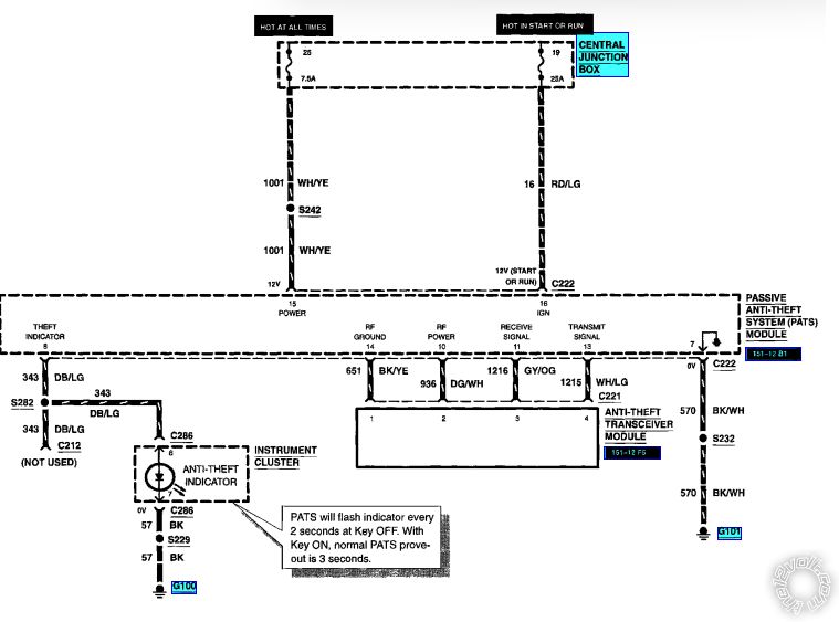

thinking about it, I'm not sure if that stuff is even in the truck anymore, I disabled pats a long time ago and to keep the security light from flashing on the gauge cluster I had to remove the pats modules.

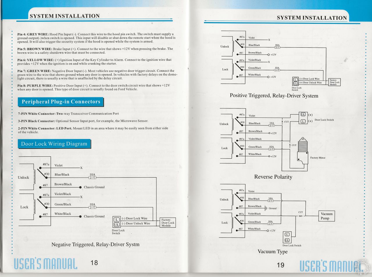

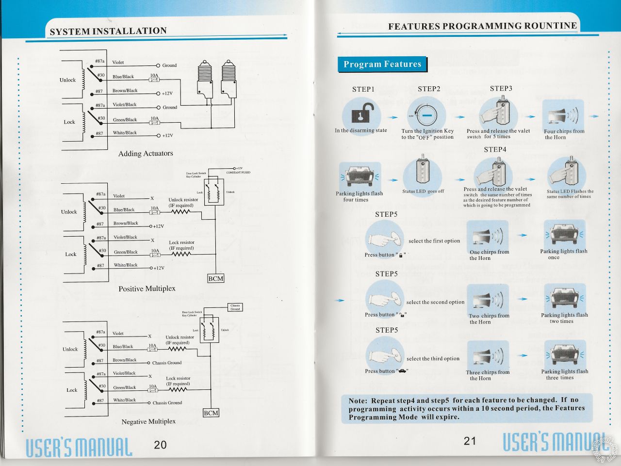

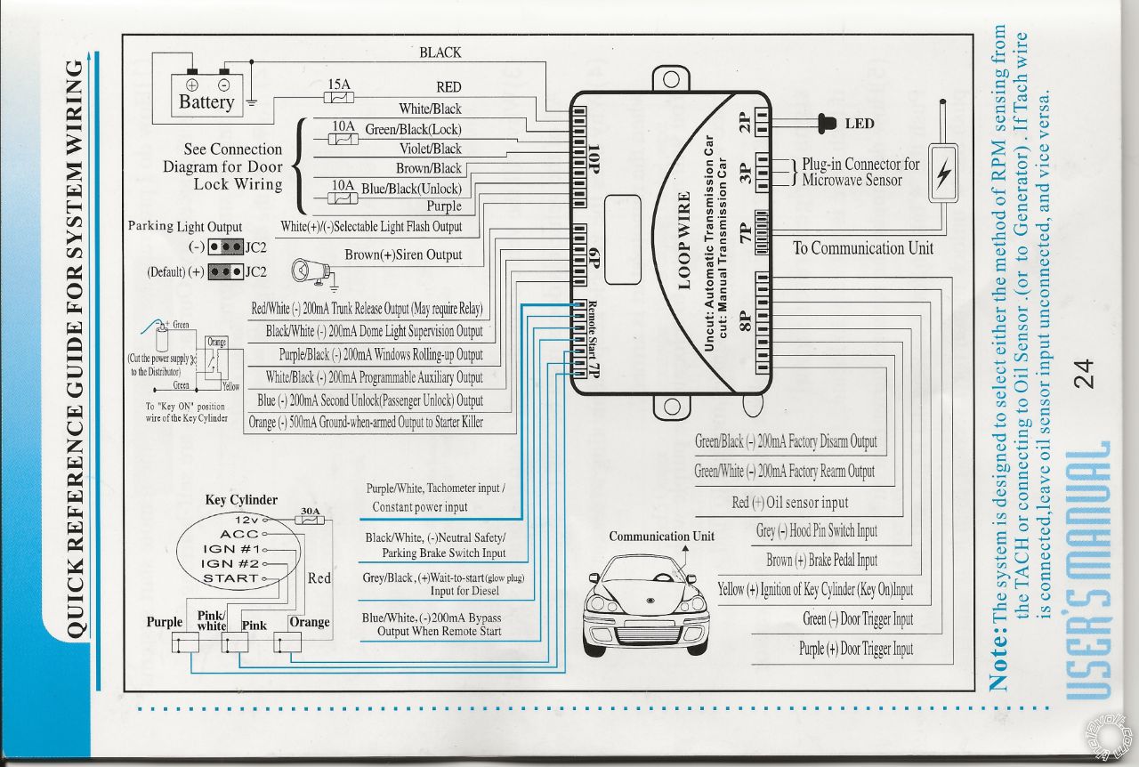

I guess I'm reading the wiring information for this remote starter wrong. I can use the disarm and rearm -outputs to trigger the door locks like recommended before but it doesn't work as well as I would like. So, I got some 5 pin relays and wired up the relay for converting positive output to negative output, which works when I use 12volts grabbed from somewhere to test but I guess this remote starter doesn't send out a positive output either. none of the wires that are marked for door lock operation send out a positive output as far as I can tell.
There is relay wiring information in the manual but it seems incomplete and I don't understand how it would work.
Can someone look at this information and help me out?
2000 Ford Exploder, Power Locks - Last Post -- posted image.
wait, am i over thinking this? is the diagrams in that manual referring to the relays inside of the remote starter? Do i just need to ground 87 and wire 30 to the lock wire?
edit: i'm pretty sure that's it and i was just being a meathead.
