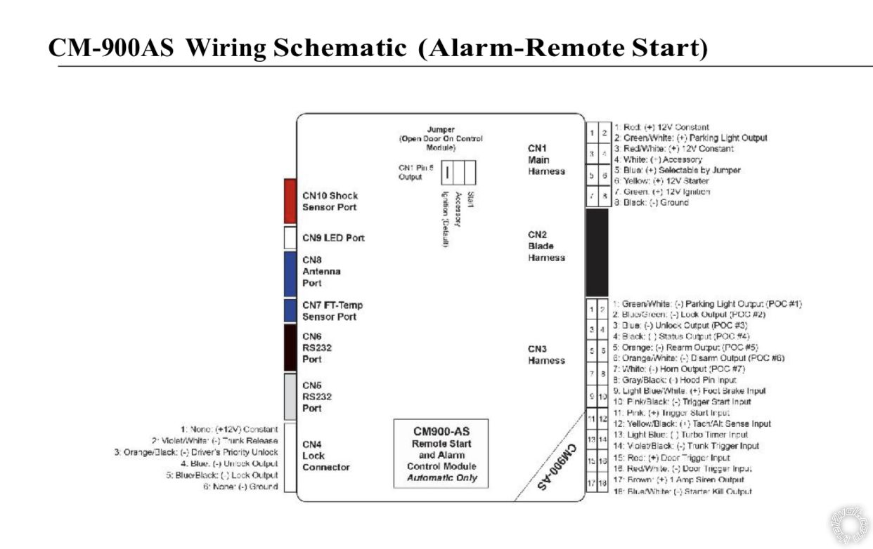

Going over the cm900as wiring there is no 20 pin connector. Are you referring to pin 3 on cn4?
2005 Dodge Ram 2500, CM900AS Remote Start -- posted image.

Posted: December 12, 2021 at 11:32 AM / IP Logged Link to Post Post Reply Quote kreg357
With a Blade-AL cartridge installed in your CM900-AS controller, there should be a 20 Pin harness plugged into CN-2. There are 5 wires used on this harness for your 2005 RAM CH-6 application.
Here is a link to that part of the install : http://images.idatalink.com/corporate/Content/Manuals/DL-CH6/BLADE-AL(DL)-CH6-EN_20191115.pdf
Your truck uses the Type 3 wiring diagram.
