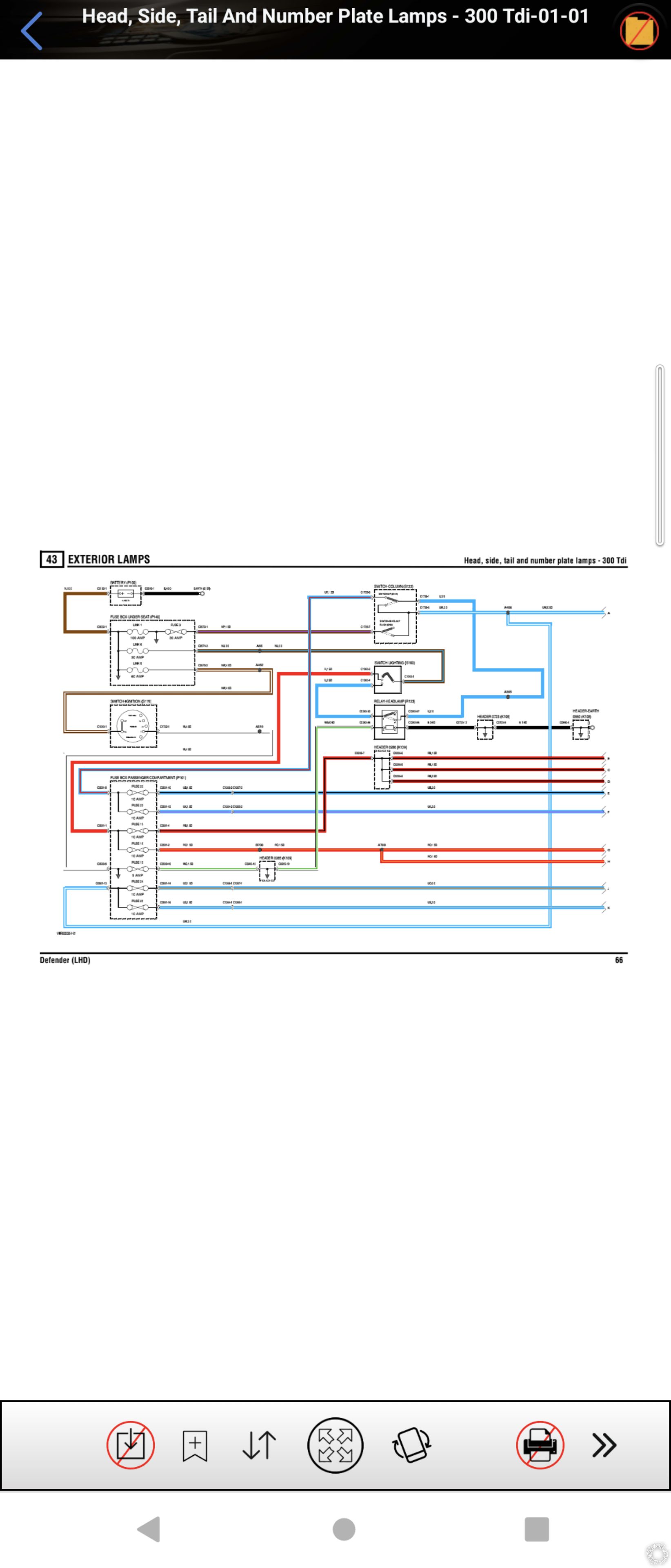

That's a nice looking project. The parking light wire is also accessible at the headlight switch. It should be red at pin 2. Viper 5906V Door Lock Pulse - Page 3 -- posted image.

Yeah, initially I was going to try and follow all the factory wiring and switches but Defenders are notorious for bad electrical (Prince of Darkness comes to mind). I pulled every wire from it and started from scratch, new engine harness, gauges, switches, everything. I wanted as much as I could to run off the GM canbus as I could and then I split up the electrical busses and added my own fuse boxes. A lot of the original would run full power from the switches so anytime you upgrade something like headlights etc, you burn up the switch, I added relays everywhere. To top it off switches and plugs all come from the UK and are hard to find so I converted everything to Carling and Metripak.
Anyways, I was poking around this morning and I lose the parking light wire I have connected when it comes through the firewall and up into the fuse box, I just can't get in there. I tried grounding it and nothing happens and when I turn on the parking lights via the switch with the ground still connected it blows the fuse. When I add power to it the lights come on and I can switch them on with the light switch without blowing the fuse. So I double checked that I have the fuse in the Viper on the + side and when I test the amp draw to the white wire on the Viper I'm getting 0.27amp so I'm thinking it's safe to assume this is going to a relay or that it's even low enough not to worry about going over the 10 amp limit. So I guess I can leave that wire alone.
