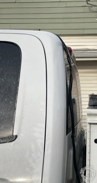

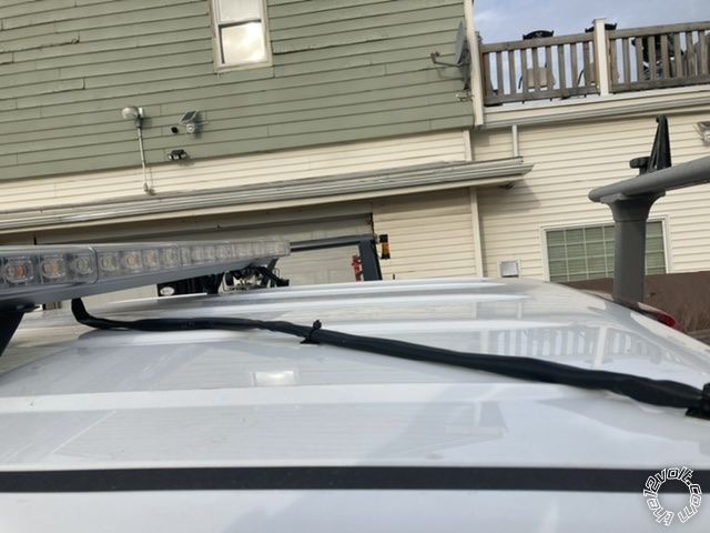

A friend of mine had a roof mounted light bar installed and hates the way they ran the wiring(across the roof and down the rear of the cab using double sided tape and zip ties). I was thinking of drilling a hole in the third brake light and running the wire in the cab that way. But it’s not something I’ve seen or done myself. He really doesn’t want to drill a hole in his brand new trucks roof.   (The 3rd Brake light is easier to replace) that’s why I was thinking of using that.
Any other ideas ?   Thanks Joe

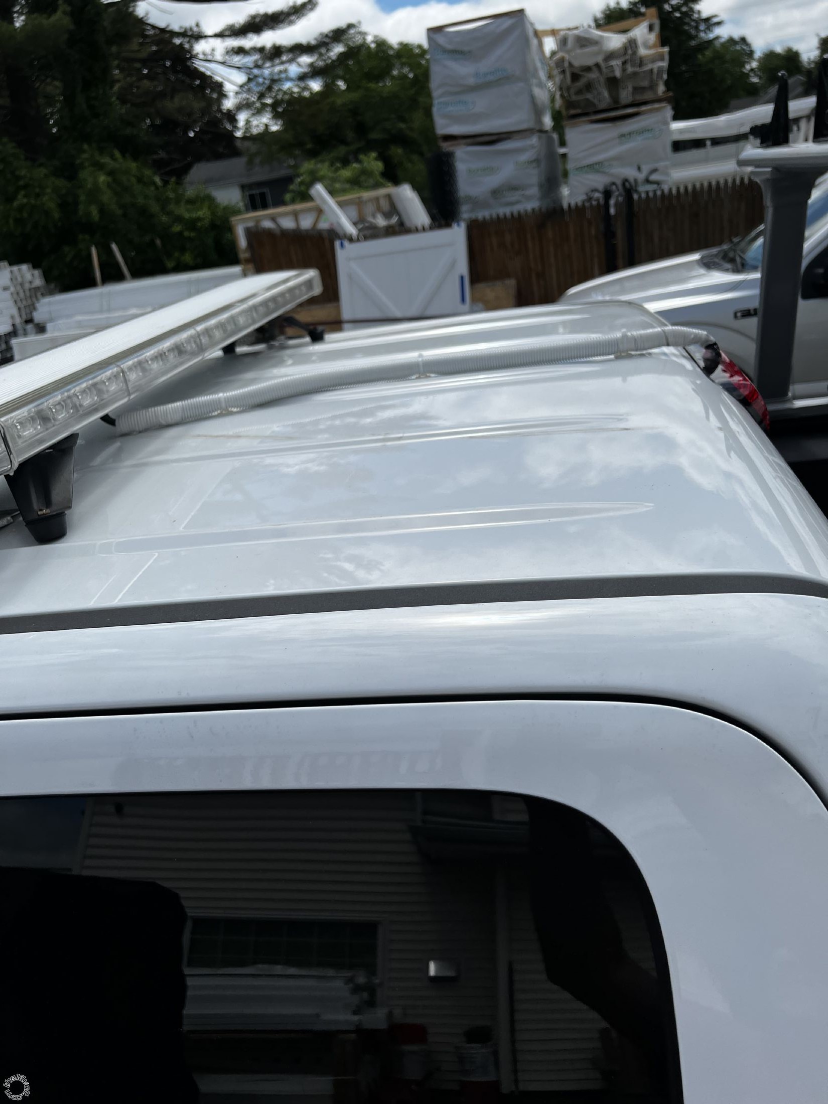

Sorry I forgot to update this. I ended up using the 3rd brake light as a pass through. Worked out well.
