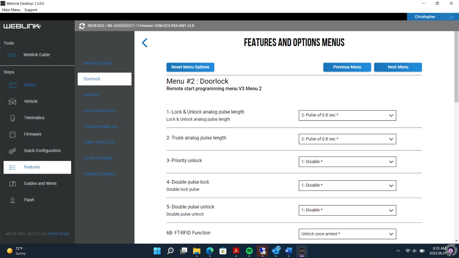

Eureka!
I think I figured it out. Bear with me…
The trick to enabling Proximity Unlock on a CompuStar CM-DC3 Remote Start control module, for use with the CompuStar RFX-P2WT13-SF Remote Upgrade Kit, lies inconspicuously in the options menus.
During flashing/options configuration, one must set the “FT-RFID” option setting under the Doorlock settings menu to the appropriate option. With the DC3, the “FT-RFID” options are “OFF”, “FTX Unlock” and “Unlock once armed” – the latter being the proper choice for enabling Proximity Unlock. This was not obvious at first since the word proximity is nowhere to be seen!
Now, with the DC3 ready, simply activate Proximity Unlock on the T13/R5 and the system should work!
I welcome any and all assistance, corrections and critiques.
Pro shop my ass… CompuStar CM-DC3 and Pro RFX T13 Proximity Unlock Problem -- posted image.

After all that module flashing and feature configuration, my Proximity Unlock is still not functional. 😕
So… I bit the proverbial bullet and took my truck to my original CompuStar installer at Best Buy, this past Friday. We formed good rapport upon our first encounter; hence, he was glad to help me with this finicky issue.
With that said, my CM-DC3 settings are correct for Proximity Unlock functionality! The “FT-RFID” option should be set to enable the “Unlock once armed” feature for Proximity Unlock to work. Unfortunately, that’s the easy part…
We are venturing into uncharted territory with this foray – my Proximity Unlock is not functional because of reasons, thus far, unbeknownst. My installer made several calls, some to CompuStar and some to his fellow installers, and here is my understanding of where we stood when his next appointment arrived:
•the CM-DC3 series has a built-in RF-Decoder which must be correctly flashed and coded at the time of firmware flashing – something I didn’t do correctly; I flashed firmware and later configured options and features
•there MAYBE some correlation between DC3 manufacturing dates and Proximity Unlock functionality – this wouldn’t make much sense because this would limit the marketability and usability of the RFX-P2WT13-SF, hence the MAYBE
•When I went to Best Buy, I only brought the T13 remote and forgot to bring the R5 remote which prevented us from programming both into my DC3; I programmed both once I arrived home, albeit to no avail
I’m headed back tomorrow for what I hope to be an ultimate fix. For those interested, I shall keep you posted.
