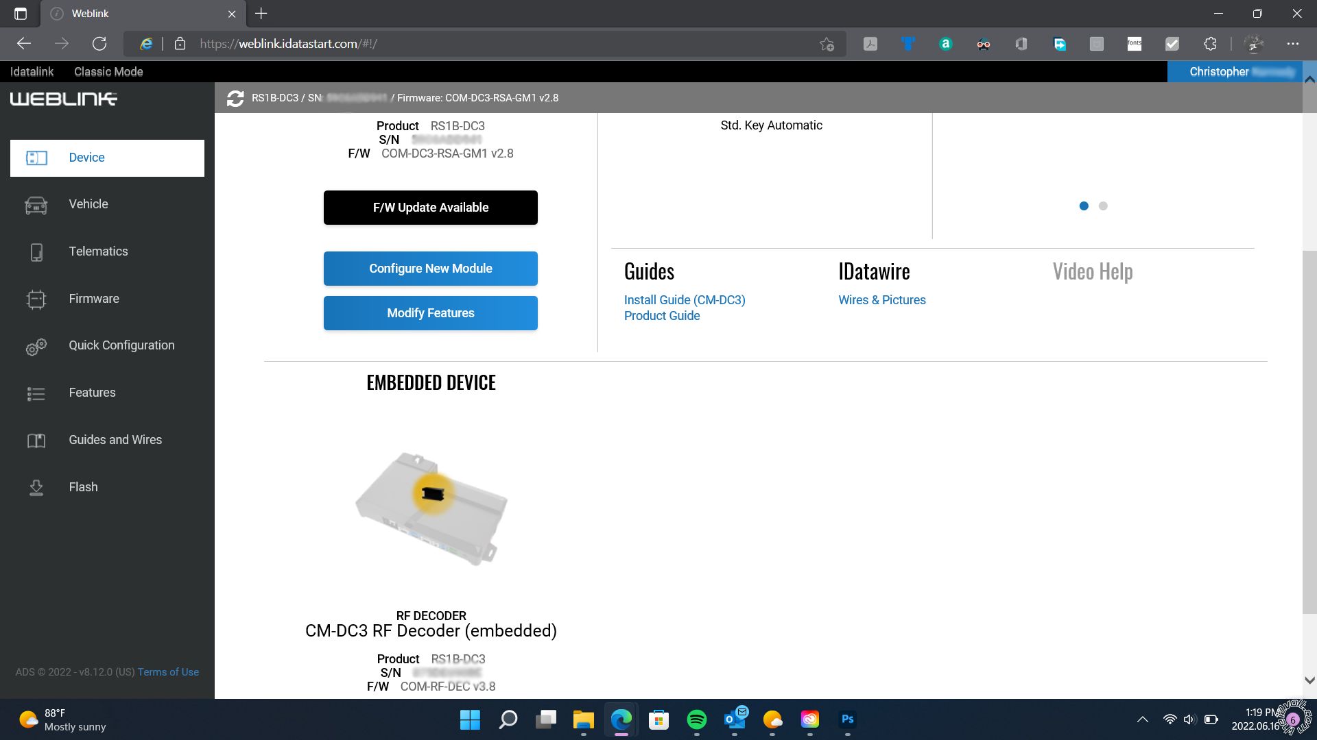

Might I enquire as to how I upgrade the RF Decoder FW? I am in Classic mode and can't make any progress. I am running version 3.6 on the RF decoder and 2.8 on te DC3.

I found it. CompuStar CM-DC3 and Pro RFX T13 Proximity Unlock Problem - Page 2 -- posted image.
Thank you, silvercivicsir, for all of your guidance. Now, I'm going to plug 'er back in and see what we've got.

I'm running DC3 FW 2.8 and RF-Decoder FW 3.8. Still no Proximity Unlock. All four remote slots are filled. All previous steps followed. The Weblink Updater wanted to "update" my RF-Decoder back to 3.6 - I'm guessing because it has a later release date compared to 3.8; I didn't perform said update. One change I did notice, I keep my siren muted for lock/unlock chirps - there is now an icon on my remote reflecting such. Otherwise, no change. "I'm stumped", said the tree to the lumberjack. CompuStar CM-DC3 and Pro RFX T13 Proximity Unlock Problem - Page 2 -- posted image.
