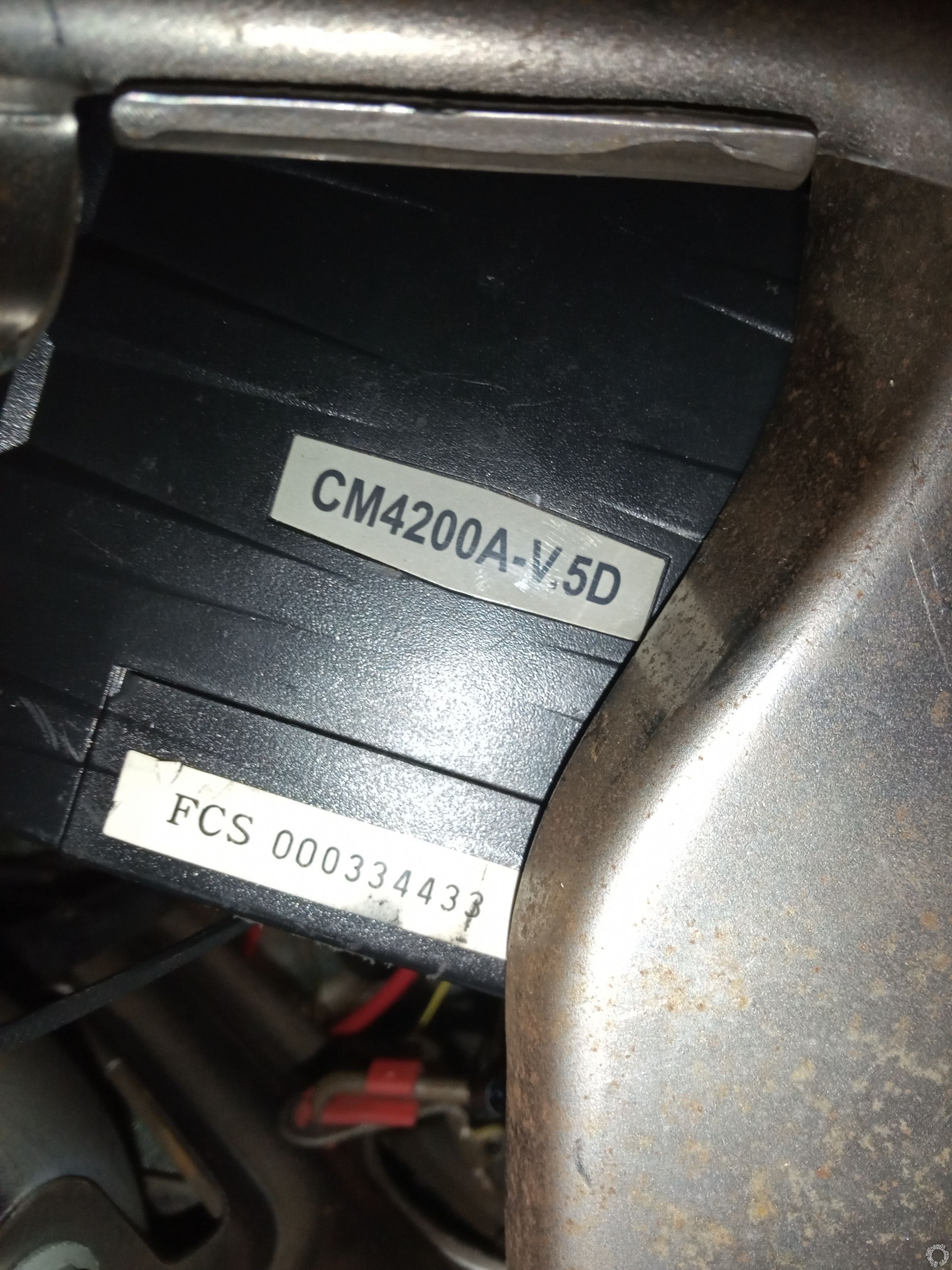

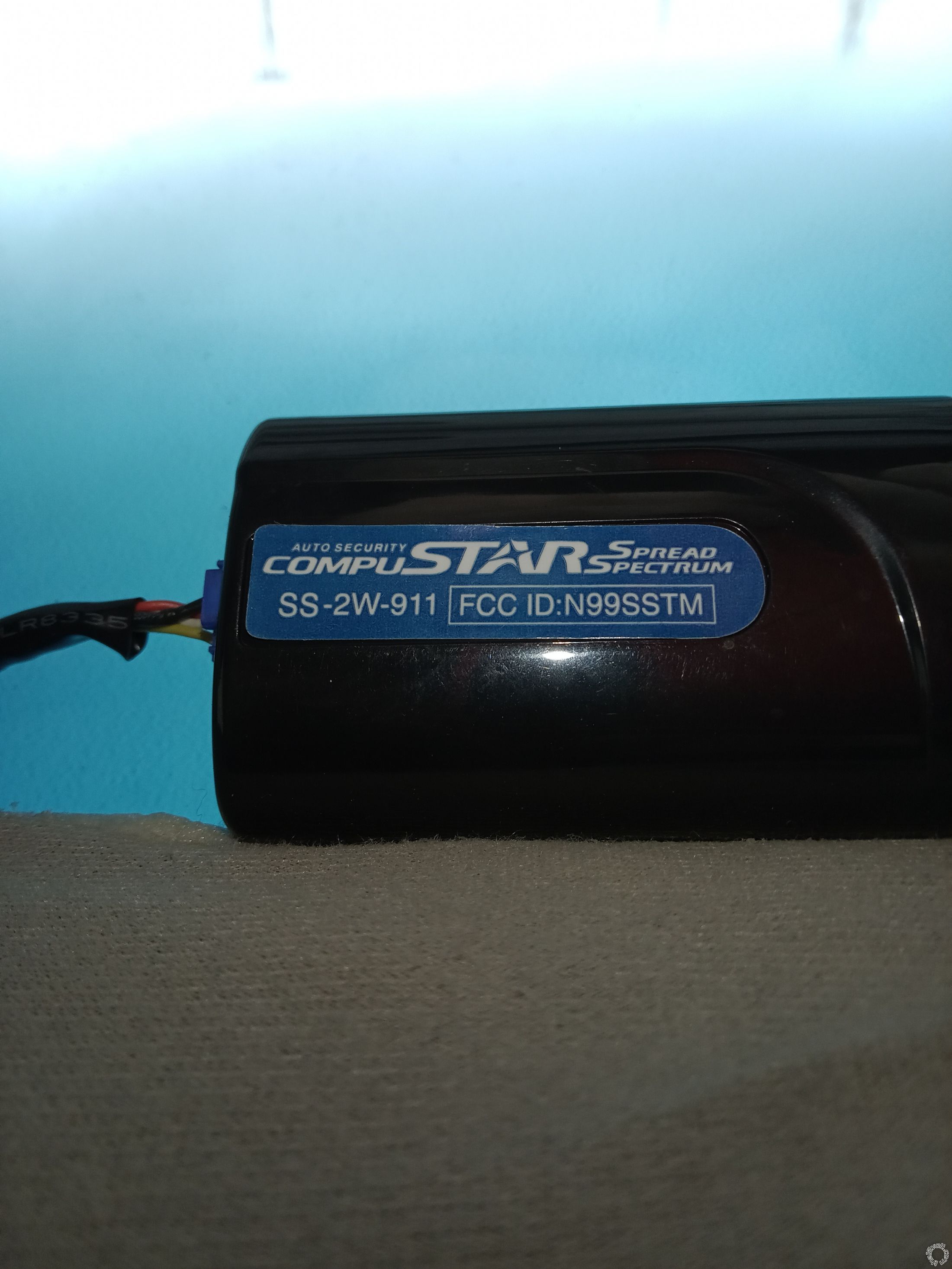

Hi, I'm new to the whole remote start field and am just genuinely a little confused. I bought this vehicle used (2001, Dodge, Grand Caravan, 3.3L V6, sport) and it apparently has remote start in it. Unfortunately I was not told this by the previous owner, nor was I given some sort of fob for it, just the factory key and fob. And I've tried the lock it 3-4 times in a couple seconds thing but it does nothing. I plan on confronting the previous owner about this, but in the meantime I've tried searching for a possible replacement fob, but from what I could find, my model was discontinued a long time ago and I'm not entirely sure what remotes/fobs are even compatible with my antenna. So I'm just wondering if there is anyone with any advice or suggestions other than just buying a whole new system. The images attached are the "Brain" under the steering wheel, and the antenna at the top of the windshield behind the rearview mirror. (If the images appear very large I apologize, not sure why they're like that) If I am missing any crucial information or anything is amiss, please let me know so I may provide it! Thank you for your time.

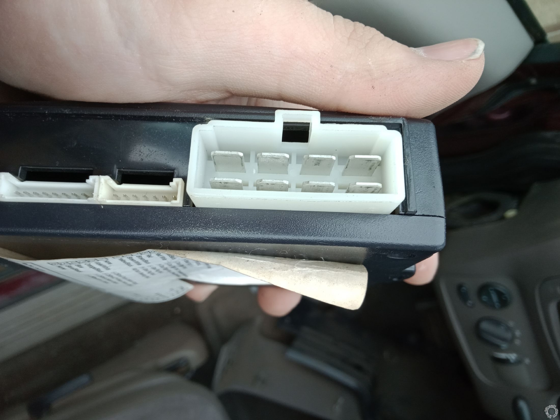

The CM4200 controller is definitely an older system. It has only the Blue 4 Pin antenna plug. The antenna is for a long range 2 way remote that was pretty expensive. I used to have a chart that listed the remote to antenna compatibility but have misplaced it. Finding a working remote for that model antenna might be a challenge. Another thing to verify is if this system is actually a Remote Starter or just an Alarm system. Back in the day they had separate models, CM4200, CM4200S, CM4200A, CM4200AS, etc. Check your system for an 8 pin plug with wires going to the cars ignition wires. Think the CM4200 A-V.05D was a remote starter system with alarm functions. If your van has transponder chipped keys, you should find a bypass module under the dash, too.
A few suggestions...
1, Call Compustar (or a local dealer) to determine what remotes will work with that system/antenna. Compustar - Toll-Free: 888-820-3690
2. If you don't need the 1 mile range and/or the 2 way feedback you could go to a current antenna kit. Being as you aren't sure the system still works you could go with a base AM 1 way remote kit for about $45 to try things out first. Pretty sure this remote/antenna kit will work with the CM4200 : Compustar Prime RF-1WG15-AP 1-Way 1500-FT Remote Upgrade Kit

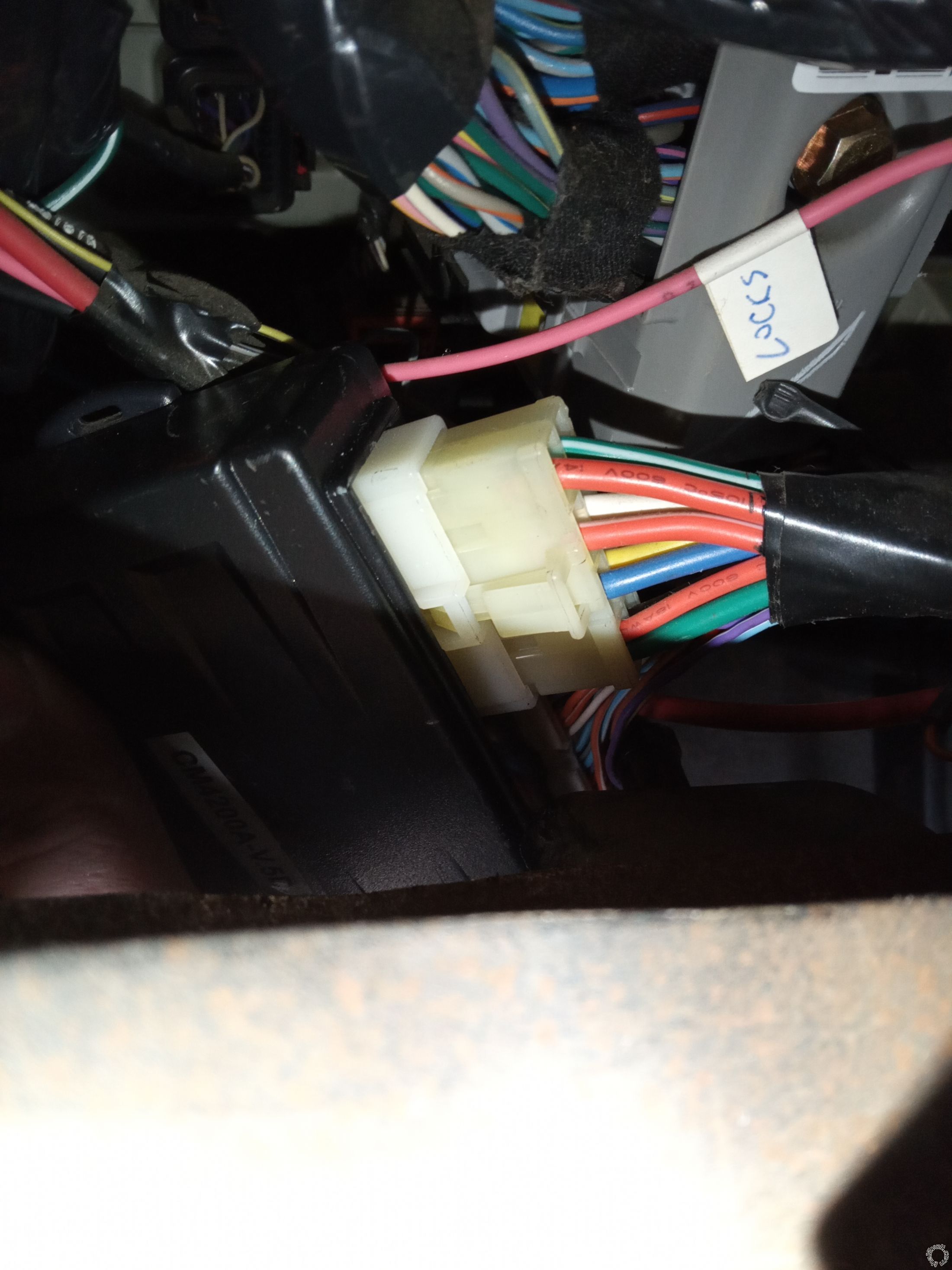

Ok, I did talk to my local Compustar dealer and they don't do anything with discontinued models they said. I asked them about a list of fobs that would work with it, but they said they didn't even have that anymore, so their no help. And my keys are not chipped and I'm pretty sure their isn't a bypass module as well, but there is the big 8 wire plug you mentioned, here's a picture of it, as well as a picture of the back diagram and where it plugs into. Haven't looked into the new antenna yet though. Older Compustar Remote Start, Unknown Fob Type/Number -- posted image. Older Compustar Remote Start, Unknown Fob Type/Number -- posted image. Older Compustar Remote Start, Unknown Fob Type/Number -- posted image.

There should be several Antenna/Remote kit options that will work. I still think a call to Compustar is a good idea. They will be able to provide the info you seek.
Being as the current system appears to have had an FM antenna it should accept another, newer style. Something like the Compustar RF-2WG17-FM should work. They go for around $100 and come with one 2-way remote and one 1-way remote that provides up tp 3,000 feet of range.
