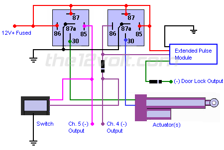

Please take a look at the attached diagram. The manual rocker switch was hooked up and worked fine. When I added the dual relay circuit (for remote control) the fuse at the switch would blow when I pressed up or down on the switch.
I can have either remote control or manual control, but not both at the same time. Looking at the diagram, why is this happening and how can I fix it so both methods can get along?
The pulse stretcher is not actually hooked up yet.
Thanks,
DarenHow can I fix this circuit? -- posted image.

Hi eloshdesign, the fix is simple, you need to cut each lead from the switch to the actuator and connect 87a to the switch side of the respective actuator lead and connect 30 to the motor side of the respective actuator lead.

Hi Daren, here ya go:
Let me know if you need anything else.

I wired it just like you have it in the above diagram, but the actuators don't move via the alarm remote. The manual switch works and the 30's light up my test light via the alarm remote (when the test light is grounded to the chassis). Are the actuators not getting ground somehow when activated vis the remote?

Hi eloshddesign, measure resistance to ground on each actuator lead at the actuators. If they are not resting at ground with nothing activated, then I'd suggest rewiring your switch so the actuators do rest at ground or even wire the switch to activate the coils of the relays to control the actuators.

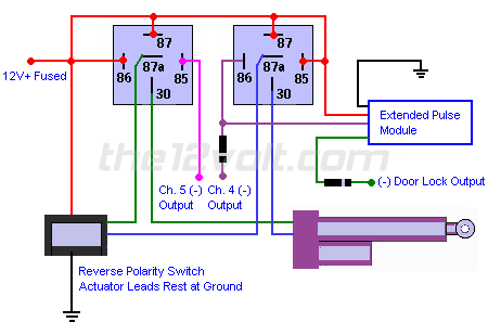

Would it be possible to do another diagram that shows the above options? It's a little unclear to me about "resting at ground". Does that mean the switch needs to grounded all the time?

Here's a diagram showing the switch activatiing the coils of the relays to control the actuators.
