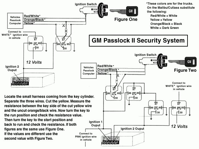

Autostart RS with PLXR bypass.Car starts for 1 sec.then shuts off.I have been at this for hrs. I have triple checked my wiring and have exausted all ideas. I think the problem lies within the bypass as the RS works in test while running with key in.Have checked grd. out while running.
Data=yellow    Bulb test = black in ign. harness...correct?
Pleeease help me.CC

Where did you pick up your tach signal?

Try white or violet/wht at pcm up high behind drivers dash. How did you wire in passlock bypass?

Folllow the above diagram i gave you you might have wrong resistance. Dont try to crank while yellow wire is cut or it will go into tamper mode.
