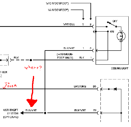

sorry - not the power lock triggers, you did tell me that (thank you Jeff) - I meant the door pin switches that trigger the dome light.  All four door pin switches pass through a set of diodes, and then there is a lead that goes off to the optional anti-theft system...  When installing my alarm last weekend, I couldn't find that wire.  It's supposed to be a BLK./WHT wire, although I suspect it will have silver dots on it also(according to the diagrams on this site)

Posted: March 09, 2004 at 12:13 PM / IP Logged
There should be a gray plug to the right of the steering column that will have this BLACK/ WHITE wire that you are looking for.

Posted: March 09, 2004 at 2:23 PM / IP Logged
Thank you!
