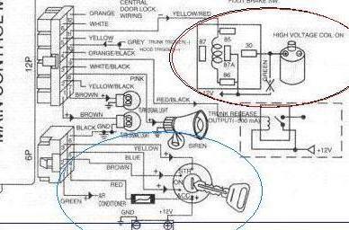

high voltage coil on? -- posted image.
yeah, this is remote start alarm. the phrase is on the diagram, (this is part of the diagram)

Ignition side of coil........

i dont know alot about these, can you tell me where is it at? please, thank you

the black \ yellow is the ignition side of the coil and there a blue\white is your tach signal,  thats  what i remember

thanks so much for your reply, i also have another question, which is the air conditioner wire?

Probably just the second ignition wire. Not necessary for start up, but it is if you want it to cool down your car.
