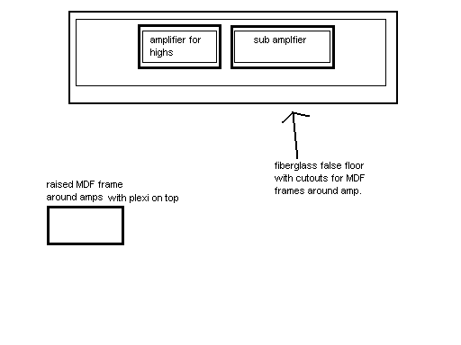

customsuburb
Gold - Posts: 1,813
Joined: January 17, 2004
Posted: December 28, 2004 at 10:54 PM / IP Logged
I agree with sexyvic. Either position your enclosure in the middle of your trunk and fiberglass a panel (you couold curve it or give it a sucked in look or whatever you want) around the box that only shows the port and the sub. Then mount your amps to a piece of MDF that fits on the floor of the trunk. Frame around the amps also and put a peice of plexi on top of each framed in box (put fans on each side of the plexi coverd box each amp will be sitting in for ventilation). Then just fiberglass a false floor that has cutouts for the framed around amps. Since I am not very good at explaining things heres a diagram of the amp rack (I hope it dosn't confuse you more).
Possible to Fiberglass a Premier 5000SPL? - Page 2 -- posted image.
