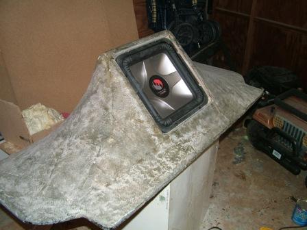

Ok, so after months of reading and learning, i finally found a candidate for some prac/app. My friend wanted a fg box built, and was willing to hire me to do it. I was going to wait till it was completely finished to post this, but i think it's close enough to done to post. the plan is to put a single 12" L7 in this mustang, where the rear seat used to be, firing towards the rear window, and the amp rack going where the rear seatback used to be.

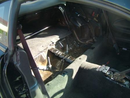

so, here's the car:
First box, w/ pics -- posted image.
and here's where it'll mount down:

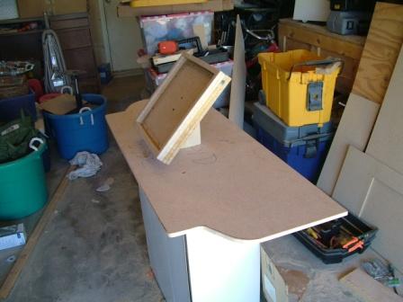

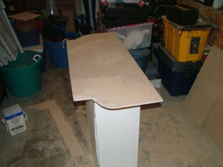

after getting a template on cardboard of the contours of the rear panels, we get our base cut:

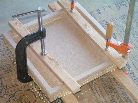

four pieces of 5/8" mdf, lots of cutting, and lots of glue, got us our ring:
ring sanded, and mounted to the base with a 2x4 to support the stretching:
and all stretched and plugged:

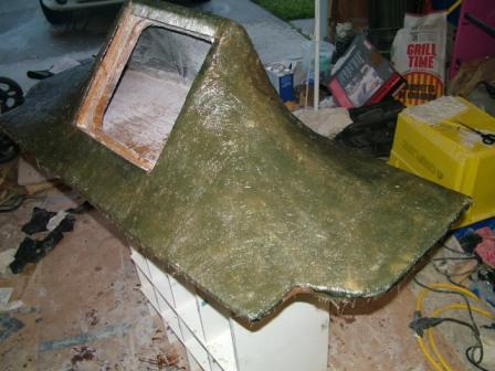

first layer of glass. over the next couple days of working on this when i could, i came to the conclusion that weave is bad, mat is the shiz:

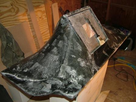

and after the 7th and final layer of glass:
then the real fun begins....SANDING!!:

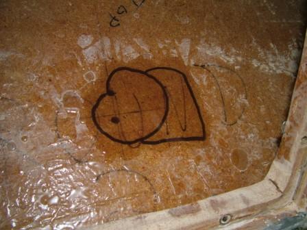

one of the many things that i learned on this project, is that i really don't like hurricane nuts. my friend ordered them from parts express because of how much better than t-nuts they claimed to be, i didn't find them to be all that. when doing a mock up with the sub, four of the hurricane nuts came out with the bolts half on them, so the only way to get them off the bolts, was to cut a hole in the bottom to get my hand up there to hold them. luckily i read in the forum how to repair such a F-up:First box, w/ pics -- posted image.

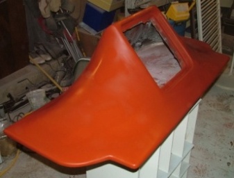

couldn't find any rage gold, not that we looked for days or anything, so went with the bondo premiere. not bad stuff:

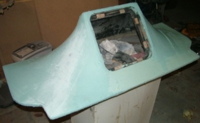

and after way more sanding:

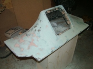

which brings us to the current state, fresh primer, waiting for wetsand and paint:
and after that's done, wire it, and build the amprack. finished pics should be in by next week. hope you enjoy.

hey, it was my first time touching fiberglass, so it's definately possible for a begginer. i've been working on it for about a month and a half, however that's just doing little bits here and there when i had the time. i just advise doing your research and having the plan before you start. while i was in iraq this year, that was what i tried to do was get as much knowledge as possible so i could start it. but i've got a couple other orders lined up, and i'm figuring they'll just get easier with experience. total working time till now is probably at about 100 hrs or so.

One hint for you though...kinda good that you used a MDF base.  Try doing a search on cabosil or aerosil on here.  Saves a lot of time instead of applying multpile layers of glass on the outside.  Basically its a resin filler.  Powdery substance you mix up with resin & hardener and makes a paste/gel type of texture.  You can you this to stiffen up the enclosure from the inside.  You basically, cut a big enough hole in the base, mix up your mixture of resin/cabosil/hardener & pour it into the enclosure.  Spread it around, make sure you get in those corners.  This stuff hardens up and forms a nice barrier that wont flex.  Try to achieve at least 1/2 inch thickness.

i have read up on the cabosil/aerosil, unfortunately i read about after a couple layers were already layed. did end up getting some q-cells though, same product basically. and yes, they were awesome to work with.
