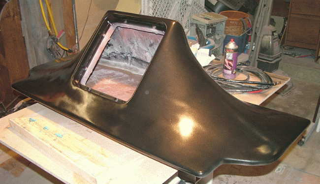

ok, the q-cells, are a super duper ultra turbo fine powder (fumed cilica), that you mix with your regular poly resin, and after mixing it, you let it sit for a few minutes, and then add the MEKP according to how many original ounces of resin you started with. then you have what i like to call peanut butter. then you spread it around and use it to fill crevaces, or it can be used to do serious buildups. right now we're using it reconstruct a console. the undesired portion was cut out, fiberglass was stretched across the opening, then it was filled with peanut butter. then we took an iced tea bottle, wrapped it with foil, then a layer of weave. after it was dried, we pulled it off, and now we have what will be the base of the new cup holder. more pics to follow after tonight, lots to be done tonight. but here's the q-cells on the console.
First box, w/ pics - Page 2 -- posted image.
and the cup holderFirst box, w/ pics - Page 2 -- posted image.

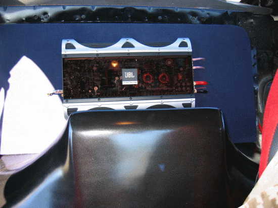

AND THE BOX IS FINISHED!!!! bout time, but it's done. still working on the panels, more pics of those whenever we get them done. First box, w/ pics - Page 2 -- posted image.

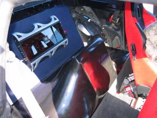

and anotherFirst box, w/ pics - Page 2 -- posted image.

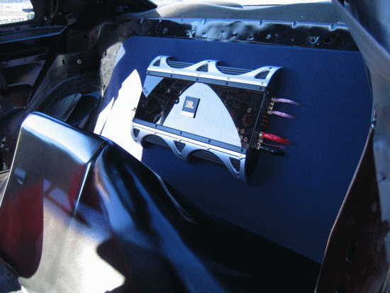

one more.First box, w/ pics - Page 2 -- posted image.
all you seasoned vets, let me know what you think... everyone else too of course.

Yeah my bad man I didnt make myself clear.  I understood what they were I was asking what piece you used it on because I didnt see it on your box.  I may just be missing it though.  But now I see the pic you posted of the console.
Good job mate on the box, looks like the amp rack is coming along nicely also.   Good job man keep them coming.
