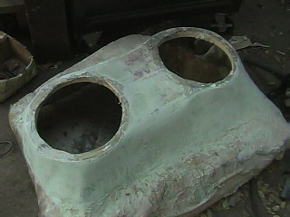

Ok here the deal, I build my enclosure already but I cant get rid of the little pits left over. I want them gone so I can paint it. this is a podded enclosure made for the spare tire well.
How to Get Rid of the Little Pits? -- posted image.
the smooth part is going to be the only part showing. the rest will be covered with carpet.

Glazing putty.

but not that bondo stuff that comes in the orange tube... that stuff is no good.

Now that I think about it, if the holes are small then high build primer would help as well.
