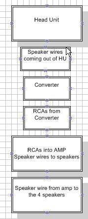

parts: 4ch amp, JL 6.5 inch in the front and JL 6x9 in the rear, using stock headunit.
objective: run all speakers from the amp to utilize a cleaner and crisper sound.
ive read up on a few other posts but cant find the exact info im trying to locate.  i ran all the wires from the speakers into the amp. ran the 4guage amp wire from the battery to the rear. ran the remote lead to the rear. and grounded it on the frame.  my thoughts are to get the analog to RCA converter for the front + rear channels and run RCA wires to the amp.  am i approaching this the correct way? thanks

Here it is
2001 Honda Accord, amp w/factory HU -- posted image.

Yes.. You will need to use two line out converters for a four channel amp. Then you should be in business. By the way...nice car!2001 Honda Accord, amp w/factory HU -- posted image.

i havent chosen an amp yet. another question is after i run the RCA wires to the amp, is the 4 ch amp supposed to have 2 inputs [front and rear] ?

4 channel amp has 2 sets of RCAs (4 cables).  I suggest some of the following amps, autotek, hifonics (these are the ones I like but there are others).

Scosche has a nice four channel line out converter (model SLC-4) that has worked nicely for me in the past. However, many amps are available with speaker level inputs, which may give you better results (or at least a cleaner looking install) than using a LOC.
