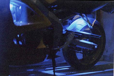

Yeah, I'm going to have to put resistors in there, much cheaper than buying the LEDs with resistors pre-installed. The thing is, I want the red LEDs for the vent in my motorcycle just for show, and I want amber LEDs in my vent that will work in conjunction with my signals.THis picture should help a little.
LED's on motorcycle -- posted image.
Now, this isn't my bike, but the lighting on the left is the vent light and I won't light my rear tire just yet. That's what I want mine to be like except in red. When I turn my signal on, I want the red (or blue in this picture) to turn off completely and let the amber flash. When the signal goes off, I'd like it to go back to red. Hope this helps.
I talked to a guy on the phone about it, he suggested a NC relay and then I talked to another guy and he said a SPDT relay. I don't know much about them. The first guy said it would be possible to get the amber to flash from bright to dark with it, and tried explaining how to wire it, but I wasn't completely following him. I think it would be fairly simple to get it to flash back and forth between amber and red, but I don't want any red in there while the signal is on.

you could... hmm. you could use a SPDT relay. hook the tail end accessory up to the relay so that the relay is constant on. Then hook up a signal wire from the tail lights that 'pulls' the relay away, breaking the circuit, and effectively turning off the tail end accessory while the turn signal is either position. A straight through wire would work fort eh front end, to let those LEDs blink with the turn lamps, as it were. i'd draw up a diagram, but i have crap for computer graphics programs...
