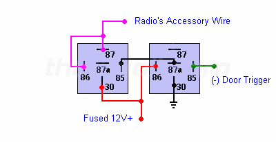

Hey I installed the radio on until door opened on my car.  It works great except for the fact I have remote start on my car and when i remote start it and when i turn it off the radio and other accessories remain on.  Since I use passive arming I want to know if I can use the ground when armed output of my alarm and also the standard door  ground input to turn the radio off .  My alarm is the Viper 790xv and the ground supplied by the ground when armed wire is rated at 500ma.  Here is the radio on until door opened drawing I used to install it on the car.
Ground when armed radio on until door -- posted image.

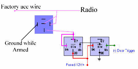

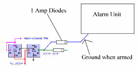

jc18750
Copper - Posts: 113
Joined: July 21, 2004
Posted: September 24, 2005 at 1:23 AM / IP Logged
That the way you wanted it to work?
