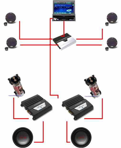

I am trying to figure out what will it take to run this setup and have no impact on power requirements or drain my battery down.
I currently have 2 alpine typer subs connected to 2 alpine mrp-m350. each amp has a rockford fosgate 1 farad CPCD10-03
what i want to do is keep this setup but add the following
2 alpine SWX-1242D 1000 watts each
2 Alpine MRD-M1005 1000 watt each
4 alpine type X 6 1/2 speakers SPX-17MB 75 watt rms 300 peak
1 alpine MRV-F545 AMP 125x4 rms
what will i need like capacitors, batteries etc.. in order to have this setup but not get ripped off with extra craqp dealers like to sell at times.

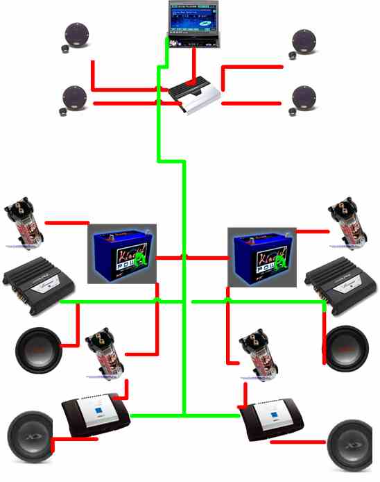

what if I get 3 batteries and wire them in a series? I seen some guys do this especially when like dub magazine brings there cars to Raceway park here in oldbridge
how much money are we talking for alternator batteries etc..? rough estimate

They make HO alternators for $250? wowa, are you shure its not a legacy alternator?? lol   Anyways "Integrity" definately drop the type-r's, put the type-x's in some proper ported boxs, scrap that MRV-F545 and get a mrv-f540, its less power according to the specs on the box, but much better built to run those type-x components. Also, are you running type-x components in the back of the car? You can do it, but it would be a little more realistic to just put some type-r coaxials in the back.  but if you have the cash, all the power to you.
But definately look into a good alternator, your going to need it , and heres my reccomended alt list.  www.mechman.com, www.meangreen.com, www.ohiogen.com, dominik irregi alternators.  stay far away from alterstart, and be weary of cheap alternators, they are just that, , cheap, they may put out 180 amps, , but most likely in the red line of your vehicle, the alternators listed above put out there peak at normal driving rpm's.

Well the entire reason I want to add the type x subs to my existing setup is to achieve more clarity with the bass and at a louder level considering the fact that I purchased the type x subs which they sound great why not add type x subs to the setup subs are subs right? wouldnt you achieve unsurpassed sound clarity if your running 4 subs versus 2 subs? if i get a chance later on to do so I will sketch out a drawing of what i want to accomplish. below is the current setup and the proposed let me know if this is workable withought getting an alternator setupPower requirements for this setup? -- posted image. and then the proposed
