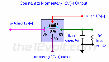

I was looking at the diagram below from this site and the one on "Momentary to Constant Output" , is there any way anyone knows that I could use something similar to these (combine them somehow), but using a (7/10sec.) accessory pulse from a remote starter to turn on a 10 minute delay to power up a defrost grid? I was going to hook a relay across the factory switch, but the connections to turn it on properly are internal and I don't feel like breaking open the switch.
If this is possible, what size capacitor would I need to make it stay on for approx 10-12 minutes?

you have the wrong diagram you can use just one relay and get your 12v turn on for the relay from the ass. wire on rs. put a diode inbetween the factory harness and where you tap the wire coming out of the rs. so it will shut off when you press the brake and the diode will prevent juice getting back through the wire to the relay from the ign. ass.

Yah, I was thinking of doing that at first as well, but want to be able to control it so it's used only when needed... I've been watching the info in the other guys thread that is in a similar dilemma as me that you posted in too fingaz.
I was hoping there would be some way to get it so its timed longer (the diagram I posted says it will stay on for only 1/2 sec., I need about 10-12 minutes) plus I wanted it triggered by the momentary output on my RS like I mentioned... Unfortunately my output in not programmable, just a 7/10sec. pulse it supplies...

well i had that in mind but it will not shut off like a factory one will. if you were to use the momentary to constant. and like in the other tread if you can tap into the defrost switch and it is the same style switch that will work. what kind of car and what year i will look up your defrost curcuit and be able to help alot better. lol

Take a look at this Post
and see if you can try that to provide your timed output. The circuit he drew out is for a short pulse output, but you should be able to use it too-
You just need to use a larger cap and resistor to stretch out the 'on' time.

That's what I'm trying to figure out... How to supply power to the actual defrost wire with a relay setup that is actuated with a pulsed output from the RS and is timed for 10 minutes or so (bypassing the factory switch)...
