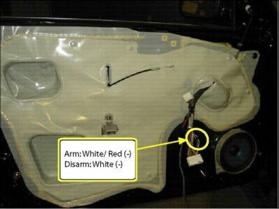

Okay next question, it says that the wires for the factory alarm arm/disarm are in the "driver door module in door"  where is this at? inside the door? and if so does anyone have a clue how to get to it,  thanks

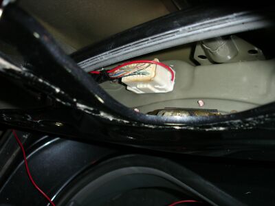

Can you be more specific? I took the panal off and I still need some direction, have you seen any pictures on the net of where it is?? Thanks , this is becoming a pain in the ***

Posted: December 31, 2005 at 12:09 PM / IP Logged
2003 Accord Remote Start -- posted image.
I drill a small hole in the plug, then I ran it thru the boot of the door.
