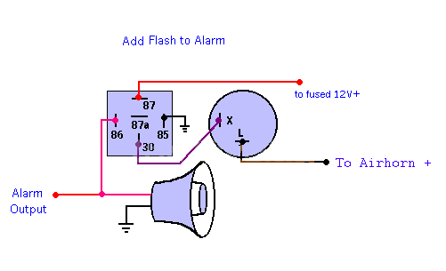

use a flasher with a relay to the horn

How would I wire the flasher and relay so they would work?

96 Honda Accord horn output -- posted image.

You could always use a relay and a combination of the siren output and the light flash output.
