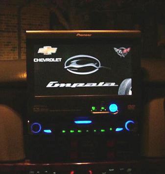

I have extensively looked online for any modding/******* to the navigation dvds for the  popular Pioneer Avic series navigation systems but I have found none.
I have successfully changed the boot image though.  I have done this by making a iso image of the dvd on my hard drive and then using a iso editing tool like Ultraiso 7 ME to pluck out the BGOPEN.JPG default bootscreen file and then replacing it with a custom one that has the same name and resolution size of 500x240.  I then reburn the dvd on a dual layer dvd, reboot the nav system with the new disc inserted (press reset) and poof!  my bootscreen is no longer saying Pioneer, but looks like this :
Modding Avic-N1/N2 Nav DVD’s -- posted image.
I am also going to try to replace the default background images,do some performace gauges customization, and insert some new alarm sounds into my nav dvd.

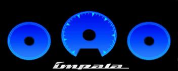

I just made my default customized performance screen.  It's kinda basic, but of course its just a test of what is capable in this Nav modding.
Now if I could just figure out how to make this N-1 read mp3 encoded data DVD's.  Anyone try this yet?  That would be bling bling baller to have a dual layer dvd with over 8 gigs of your favorite mp3's, eh?
I'm gonna try a crystal clear version of this to see if I can see the wallpaper image behind the face of this template.
