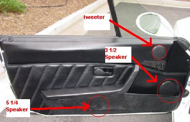

I have door panels that have provisions for a 5.25, 3.5, and a tweeter.  I'm looking for advice for a setup that would result in the best sound quality and sound stage.
Some info I need are:
  • type/brand of speakers
  • cross overs required
  • should I reinstall the deleted 4 x 6 speakers in the rear seat area?  Or will they ruin the soundstage?
The car's info:
  • 2-door coupe
  • has 8" sub in the hatch area and is powered by a mono sub
I'm not looking for pounding bass, just good overall sound quality that can play loud music well.  I don't know much, but I like the sound system in the Lexus SC400.
3 Speakers in Doors, Advice Needed -- posted image.

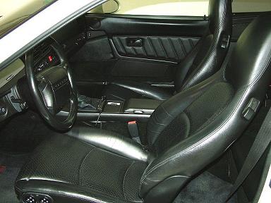

Here's what the cabin looks like:

Look for a 3-way componet set.  There are many of them out there and they will come with the proper crossovers.  Go shopping and buy the one you like the best that you can afford.  3 Speakers in Doors, Advice Needed -- posted image.

Alright first, whatever speakers you do go with the amplifiers that are in the vehicle are going to have to be bypassed (assuming it is some kind of upgrades sound system bose, jbl, harman etc) Then when you do the fronts the rears are going to have to be done too. So basically your going to rip everything out and start from nothing. And im not discouraging you, just giving you a heads up. As far as the 3 ways....hmmmm not sure i know focal makes some really nice 3 way set ups but as i go through the catalog there arent any that are set up in those sizes. My suggestion would be cut out that 3.5 and just run a nice set of 5.25 components. Check out the Boston Pro 55, Focal 130v2, or even the JL ZR525CSI or Focal 130KP if you want higher end.

I can't seem to find a 5.25", 3.5" / 4", and tweeter component set for the life of me.  If anybody can point me to a nice set, that'd be great.  I'm willing to spend around $200-$250.
If I can't find 3-way components, here's my plan B:
  • run 4" components in the stock tweeter and mid-range locations
  • run a 5.25" speaker under the armrest
  • use a 4-channel amp - send the mids & highs to the 4" comps and the lows to the 5.25" speakers
  • keep the 8" sub in the hatch area, which has it's own dedicated amp
I like this route b/c it doesn't require cutting the door panels and I can re-use all the stock locations.
Any comments and suggestions are welcome as I'm still new to all this stuff.

You are not likely to find a 3-way component set for $250.  I'm not even sure I could build one for that. If you proceed with your plans of adding a 5.25" midwoofer to a 4" component set, what do you plan to use for a crossover?  I also do not see how you can do this including the cost of the required new crossover and keep it under $250.  A better route for you might be to get a decent sounding 5.25" component set and forget about the 3" location in your door.  Just because there is a hole does not mean you must fill it.
If you are a good crossover designer, however, and want to try your idea, Madisound has some great closeout prices on some decent sounding Audax speakers.  One of these might work as your midwoofer.
