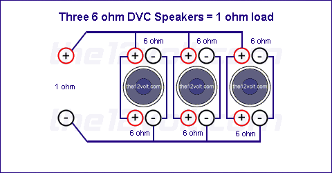

Since when is it possible to run ONE mono amplifier to THREE subs at one ohm stable? How is it even possible to run three speakers period to a mono amp? I can see two speakers, but three?
dwarren
Joined: December 03, 2004
Posted: March 02, 2006 at 11:29 PM / IP Logged
Like this;
1 ohm stable amp -- posted image.
Remeber you present a load that is higher than one ohm to a one ohm stable amp, like 1.5 ohms or 1.7. So it is very possible

Thank you very much for clarifying that, dwarren and boardinbum!
