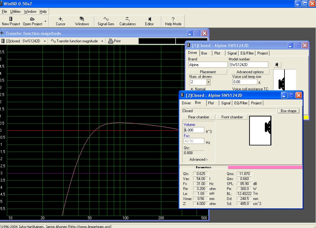

Don't port the box for these subs.  They work best in a sealed box and 3 cu ft each is a great enclosure for them.  Give them close to their rated 300 watts RMS each and you will have a killer SQ setup.  Here's a screenshot pic of what the sound would look like:
What you see here is a nice SQ response, meaning the sound will be natural.  The F3 hits at about 37Hz, which is good.  There is very little peak in the response...in fact I would call this no peak at all.  Read my tutorial on WinISD to get to the point where you can do this type of thing yourself.  I went to the Alpine site, pulled up the specs, and ran it through the WinISD program.  That's what you are looking at in that pic...the picture of the sound.  And the picture looks good.
Forget about porting, period.  You cannot improve on these subs in that manner as they are made to prefer a sealed enclosure.  The work you have to do at this point will be in (obviously) covering the box, and situating those subs where you like them.  They are fine to operate in the position they are in.  My biggest concern at this point is how you constructed the box...does it have bracing?  For a box of this size, the expanse of the walls is big, so bracing is necessary to eliminate flex.  If the box is one big open cavity, you should re-open it and install some 2X2 studs (or even use smaller 1X1 pieces) between the centers of the large sides.  This would brace the enclosure front-to-back and side-to-side.  You'll have a nice killer system that wont' be improved upon as long as you follow the steps in setting up the REST of the system.  Importance is placed on setting the amplifier gain properly.

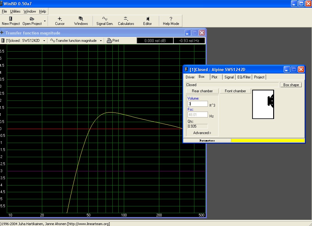

3 cubic feet is not that much space if you think about it, wildkartunes.  We are so accustomed to downsizing to fit a car when we deal with car audio.  "Sloppiness of bass response" is mostly a myth perpetuated to conceal the innacuracies of the actual build.  That's why everybody who is deeply interested in car audio should take some time to get to know a box modeling program.  You can see the results before you do the build.  I brought these subs back up to show what the smaller box, 3 cu ft net, would result in:
You see an increase in the peak, and a Qtc that jumps from .808 to .935 (where .707 is the ultimate goal).  F3 now hits at 40Hz instead of 37Hz.  By using a smaller airspace with these subs, you would decrease their SQ value (lose some low end response and cause a disproportionate amount of power to go to the freqs in the 70 to 80 Hz range).

That's no relation to db, right?
Do whatever makes you happy in life without diminishing the happiness of others
stevdart
Platinum - Posts: 5,816
Joined: January 24, 2004
Posted: March 25, 2006 at 5:29 PM / IP Logged
The db relationship is to the center line, not actual SPL.  There's a SPL chart for that.
