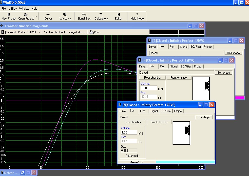

I take it that going to a 2ft^3 box to get rid of a 2dB ripple is really not worth it.  Would you be satisfied with a 2dB ripple in your box/sub if you were not going for SPL?

Well dude, I think you got this thing nailed.  After your initial post in which I thought you might be a little bit on the clueless side (sorry, my bad!), you started to intrigue me with what you began to show.  So I worked this thing up to satisfy my own curiosity, and it looks like a 2 ft^3 box with the mid insert is the way to go.  Good work!
Here's a shot of the responses:  the lavender is 1.25 with no insert;  the white is 2.0 with mid insert;  the aqua is 1.25 with mid insert.  What you came up with looks the best.

Thanks for the compliment.  Trust me, I was clueless till like last week when I first started visiting this site!  I still have a lot of reading to do.  Last week, I just figured I could get a RF amp and sub, throw it in a "recommended" size box, and it would work.  Thanks again for the help.  I won't be able to start the install till the end of the year, but of course there will be pics for all to see!  Now I have to figure out how to bring the sound stage up with the front speakers.
