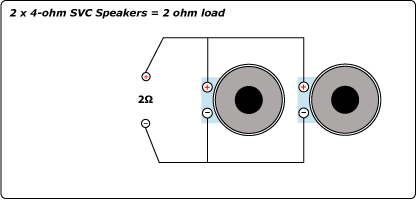

xtremej
Gold - Posts: 1,440
Joined: February 24, 2006
Posted: April 08, 2006 at 11:53 AM / IP Logged
best way to hook up 4 10 subs - Page 2 -- posted image.

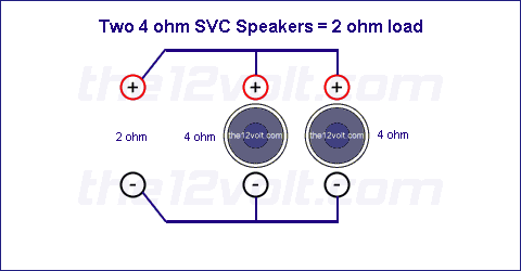

Aruman
Silver - Posts: 363
Joined: July 27, 2005
Location: Aruba
Posted: April 08, 2006 at 11:59 AM / IP Logged
2 of the Pioneer GM-7200M Class D amp should be good also, i don't think you will be able to find a pioneer amp that is 500 wrms at 1 ohm. check two of those amp and wire them as the picture below, and go easy with the gain setting. those amp is 360W x 1 @ 2 Ohms, and 2 of those sub are 240 wrms and wired in parallel is a 2 ohm load.
