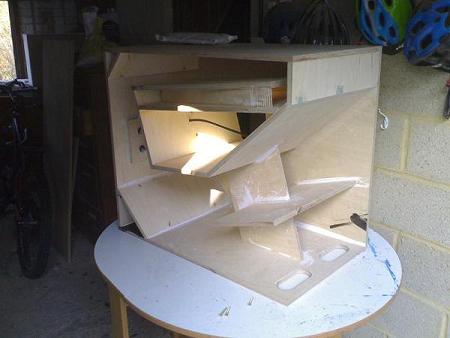

I may be the only person on this forum that does this, and there may well be a good reason for that, but you could consider using pro audio drivers rather than automotive components. The reason for doing this is the massive increase in sensitivity, giving you much more volume for the amount of input power you have available. To give you an idea of the difference the new JL audio 12W3v3 has a sensitivity of 87.15dB 1W/1M, whereas the eminence delta 12A i use (x2) in my sub has a sensitivity of 98.3dB 1W/1M. This equates to around 10 times the power input to the JL driver than the eminence driver to make the same SPL. The downside is that excursion on pro audio drivers is significantly lower. I decided to try doing this because of my pro audio background, and so far i am very pleased with it. I'd like to know if anyone has any opinions on not using automotive/mobile audio components. You may find it interesting, while im blabbering on about sensitivity, that i've built a horn loaded sub that has an efficiency of 102dB 1W/1M and with a 350W input from my amp will blow the bloody doors off! The picture below shows the sub missing its side so that you can see the horn section (which is 7 feet long!)
