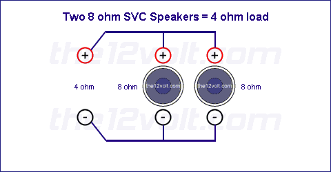

cva, if you're using 2 - 8 ohm speakers, connect them in parallel. This will bring the impedence to 4 ohm mono. Run your amp in bridged mode and you'll be set. Here's the wiring diagram.
Option 1 (parallel) = 4 ohm load
Speakers wired in parallel
Recommended Amplifier: Stable at 4

yep, that is correct. on the rf2002 in the bridged setting that will drop your 4 ohm into a 2 ohm inside the amp. this maximizes your woofers and your amp. btw flakman, i love your quote. good luck and hope this helps.

Thanks for all the help on this. I wired them the way flakman advised, big difference on the amp. It didnt get as hot and didnt need as much gain to get equal sound as before. I really appreciate the help to all that replyed.
