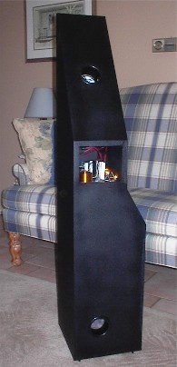

Okay, this is from experience.  The MDF has two types of surfaces:  the ultra-smooth flat side and the edge.  The edge of a 3/4" sheet of MDF is the 3/4" part of it.  It is porous, and soaks up paint.  If this edge is not sealed to the degree that the flat surfaces are sealed, the difference will show when paint is applied.  Instead of a blemish-free result, you would see the unfinished edges of the MDF through the paint.
Enclosure Covering -- posted image.
Look at the left side.  You can see the edge of the MDF because I didn't get it sealed well enough.  It's tough to see with a cheap camera and a few kilobytes, but you should still be able to discern a line running down along the left side.  That shows how the paint "took" differently on the edge compared to the finished side.  Some of that is also glue that was sanded down.  The point, though, is that any irregular surface (MDF edge or glue residue) has to be treated with a sealer, or primed more, than the majority of the enclosure.
