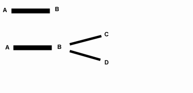

Imagine a rope that goes from point A to point B is 1" thick and can deliver 100% to point B.
Now split that rope at point B into 2 smaller ropes each 0.5" thick going to points C and D. They are delivered 50% each.
In your original stereo configuration, point A is the headunit and point B is the rear speaker.
In your NEW stereo configuration, point A is the headunit, point B is the hi-low adapter, point C is the speaker, and point D is the amp.
Now read the analogy again and you should see why the signal going to the speaker is weaker (less wattage being delivered).
factory stereo to rca adaptor -- posted image.
It's not an exact 50/50 split, but you should get the general idea. Your headunit only has a finite amout of wattage that it puts out per channel. If it puts out 25 watts per channel, then each speaker gets 25 watts. By tieing into that line you are essentially robbing some of that 25 watts and sending it to another device (the amp).
