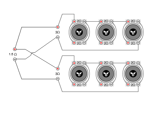

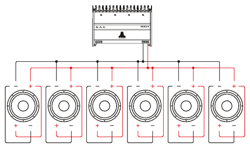

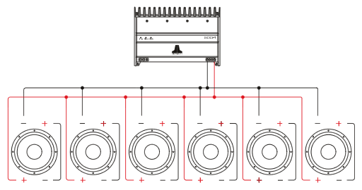

or
(6) 2ohm DVC drivers with Voice Coils in Series / Parallel: 0.7ohms

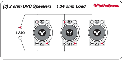

Unless your amp is sub-1ohm stable, then I suggest taking coppellstereo's advice and use both amps with (3) subs per amp like this:
(3) 2ohm DVC drivers with Voice Coils in Series / Parallel: 1.33ohms
